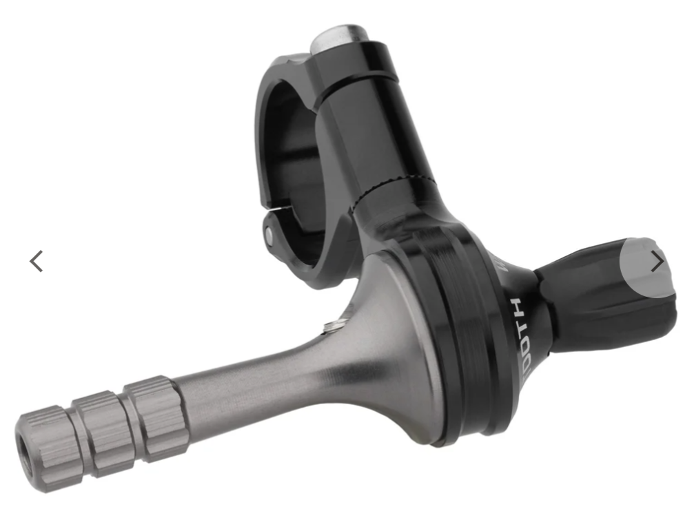

Posts: 8180
Most people's needs are covered by the options above. However if you have a front shifter (??) or remote lockout lever on the left then you'll have difficulty getting a dropper lever to play nice. In those cases or if you needed the lever on the right I've had good success with the Wolftooth remote 360. It's design is the most flexible position and activation direction wise. Activation is from any direction and mounting you can put it above, below, alongside, rotated up or down etc into the ideal position.
