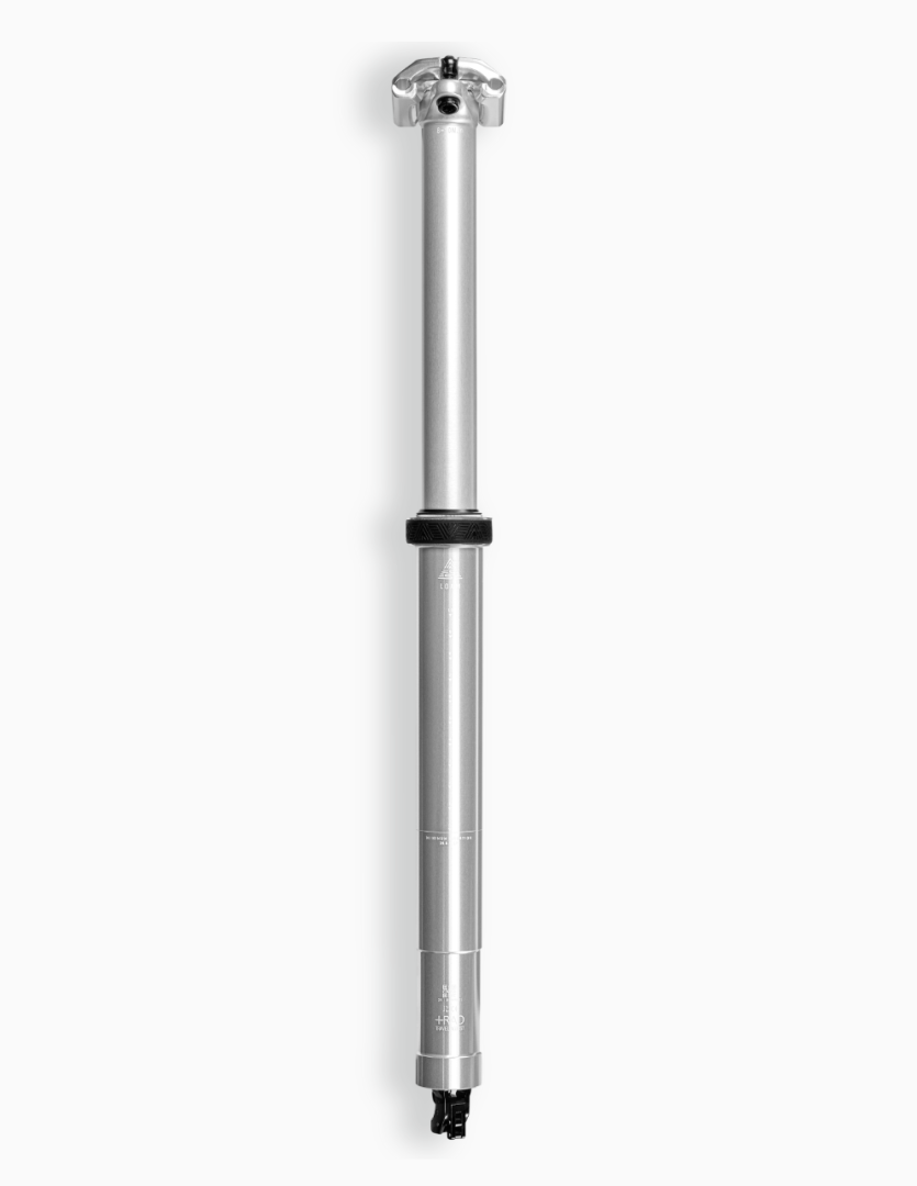

I've just ordered a 225mm PNW Loam for my Ti Switch9er - will report back when in use

I'd expect the PNW post to be good but be honest, you only ordered that because it is silver! 😀

Posts: 14713
Posted by: Rubber_Buccaneer
100% 🤣

[ I also have bought one of those silver PNW, for one reason and one reason only 😂 ]
