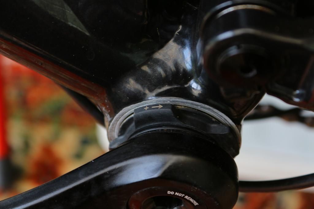

… the cross shaped adjuster betwixt crank and BB.
WIll it help me tame the intermittent creak from my BB?
Advice gratefully received.
Posted : 15/06/2014 12:34 pm
BB bearing pre load adjuster. Won't help creaking unless it's caused from being loose.
Posted : 15/06/2014 12:37 pm
Posts: 119
It turns to adjust the preload on the bearing rather tha. Useing the silly little plastic shims
You can try to tighten it a little to remove the creak but probably needs either some bearings or the cups are moving I the frame
Posted : 15/06/2014 12:38 pm
Dunno but the XTR BB on my mtb has a tensioner/retainer type thingy that eliminates play in the crank. Not sure why but the xt and slx don't.
Posted : 15/06/2014 12:39 pm
Posts: 9
Because XT and SLX have a preload cap on the end of the crank instead.
Posted : 15/06/2014 12:42 pm
Posts: 13282
Thanks. Shouldn't be a wear problem as I've only done 600miles.
