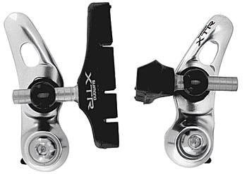

Posts: 91
Posts: 91
These retro XTRs are good but hard to find. I've got them on my commuter, they are great for a close clearance frame.
[img] http://www.motoclasse.com/images.php?image_id=3395&width=415 [/img]
Posted : 23/10/2010 11:45 am
