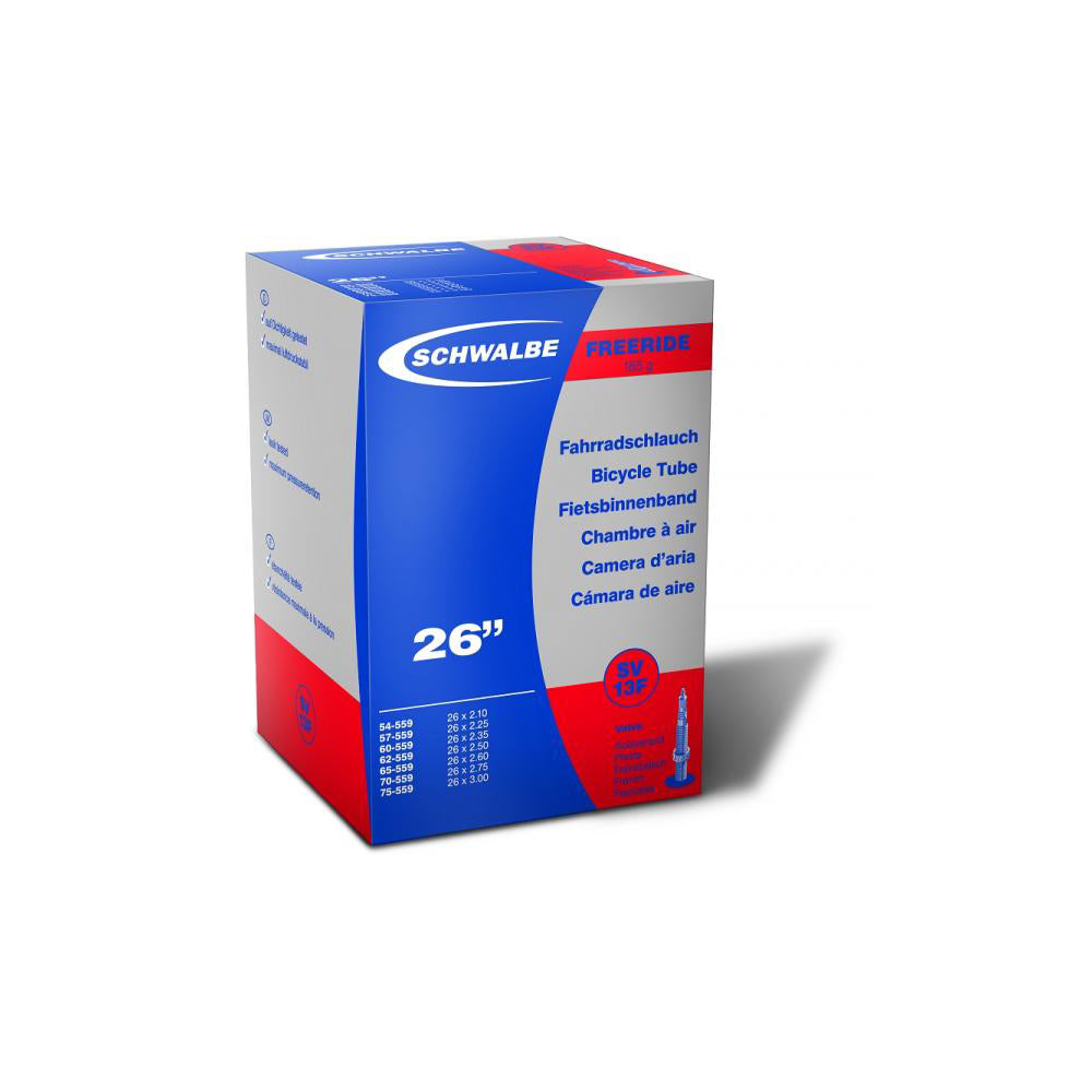

I keep looking at potential upgrades for the Wazoo, in terms of improved riding comfort and even better if they are weight saving, but it the upgrades could easily get more expensive than the original bike cost without getting too silly! 😆
2x SV13F tubes ~£12 (~440g loss)
RDS front wheel for Carbon Fatty Fork ~£40 (unknown gain/loss)
Carbon riser handlebars ~£60 (~240g loss)
Pair of Juggernaut Pro / Jumbo Jim / Fast Track Fat tyres ~£90 (~800-950g loss)
Conversion to 1x/2x10 ~£130 (unknown weight loss)
Carbon Fatty Fork ~£150 (~900g loss)
On-One Fat Not Fat 29er wheelset ~£299 (~1500g loss?)
Part of me thinks just get the tubes, a set of BSC type 1s for tarmac commuting plus the gearing upgrades and be done with it!

Nobody, I kept a spreadsheet of the difference my upgrades made in weight 😳 or 8) as appropriate
OE New Difference
post 350 175 175 CF post I already had
saddle 410 280 130 WTB Silverado I already had
bar 380 315 65 Havoc 750mm, chosen for width, and I already had
F tyre 1550 1390 160 Changed for O-O Floater for grip in mud
R tyre 1460 1430 30 Ditto
F tube 420 181 239 Schwalbe FR tube
R tube 415 190 225 Ditto
F gear 498 50 448 ditched mech/shifter etc, replaced with 30T NW
R gear 1180 1040 140 SLX cassette and chain, Zee mech and shifter
So most of the changes to improve performance but lost 1612g in the process.

Think I'm going to pull the trigger on some Jumbo Jims* and a pair of sv13f tubes tonight, jury is still out on buying an Exotic 750mm carbon riser bar in the Ebay 20% deal. Not a bad little combo for ~£135. 😈
* Thinking snakeskin in case I try tubeless at some point, like kayak23.
Posted : 31/03/2016 8:21 pm
Posts: 9351
Went with snakeskin JJ 4.0s in the end, 1090g and 1129g, with a pair of FR tubes that were 193g each. When I finally get the 20% off voucher refund, which I had to chase up again yesterday, they will have cost a few pennies under 90 squids delivered.
Planning to hopefully fit these this afternoon or tomorrow and see how they feel, albeit it's now been over ~2.5 weeks since I last rode due to this man flu thing, that is still yet to shift completely!

Schwalbe do two fatbike innertubes I know of, a very safe bet sv13j @ ~390g and a slightly more risky sv13f @ ~185g. I've got one of each installed, after one of my freeride tubes split along the seam during its first inflation.

Might be too late, but SJS cycles have the ~185g SV13F tubes at £3.99 each...
https://www.sjscycles.co.uk/inner-tubes/schwalbe-sv13f-xlight-fr-presta-tube-26-tyres-54559-to-75559/ (p&p extra)
Or free delivery for spending £10 or more via http://www.highonbikes.com/schwalbe-sv13f-mountain-bike-mtb-inner-tube-26-x-2-1-3-0-presta-40mm.html
Posted : 17/08/2016 7:59 pm
I'm not long in so nothing ordered yet. I'm totally in the dark with regards to fattie innertubes. Any recommendations which to get?
I was probably just going to get the On-Ones.
edit.... Just noticed none of those tubes seen to be fattie specific ie don't go too 4" in size. Does that mean I can use normal 26" innertubes? I still have a few from my old full suss.
Posted : 17/08/2016 8:33 pm
Posts: 9351
I'm no skinny rake at ~85Kg, I have an SV13F on my rear wheel (simply because I did that wheel first and it inflated fine) and an SV13J on the front (because the seam split on the second SV13F after just three strokes of my track pump). So ~600g total innertube weight.
Two On One fatty tubes would be ~1100g, if my memory on weights is correct.
The Vottorias are complete unknowns, the only version with no claimed weight is the fatty tube, I'd hazzard a guess of at least 400g per tube going on ~192g for the 26x1.9-2.1 variant.
~£11.50 for a weight saving of ~700g is the cheapest weight you will lose off the default bike, if you don't want anything else from PX to get over £50 free postage then the tubes will cost ~£9.50 using TCB. 😉
The SV13F seems to inflate fine to 4" tyres in most cases, with the odd failure like one of mine, despite officially being 2.1-3.0" range. I would not recommend using a normal small 26" tubes, these Fs are designed for robust riding.
Posted : 17/08/2016 8:53 pm
