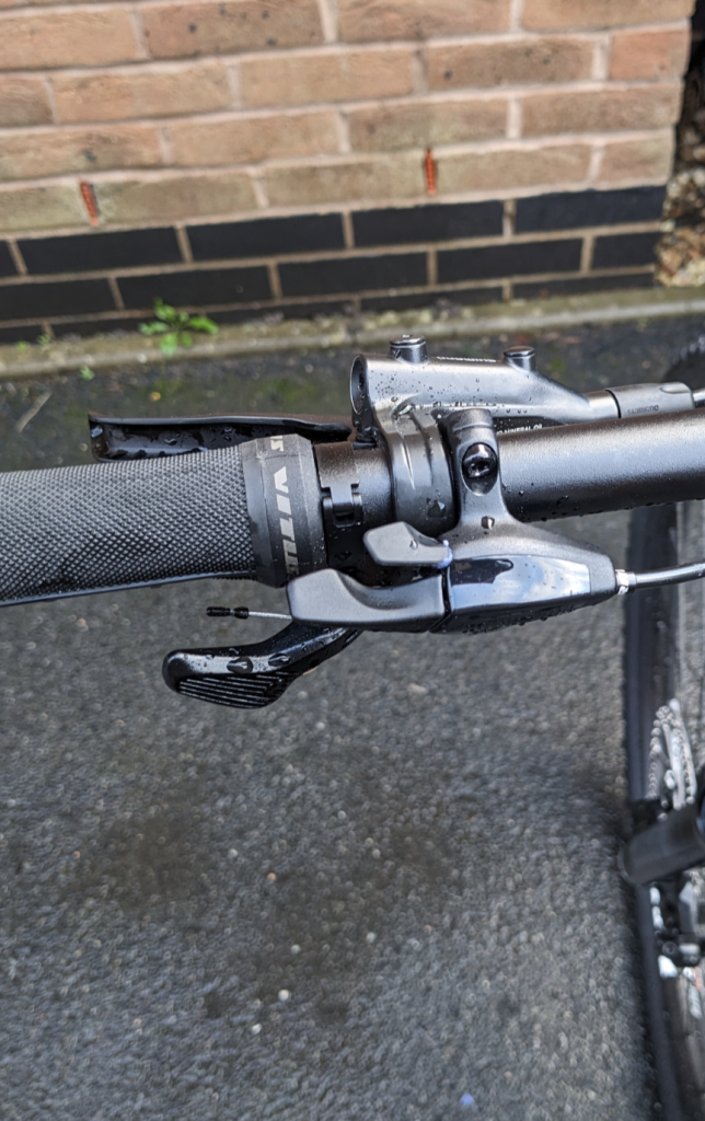

I've fitted a dropper lever and left the lockout remote on my daughter's.
Screenshot_20240225-214226

Thanks guys, that is useful. I got a brand x post. I'm not sure if that matters for using a twinloc or similar system. I will look to see if they are easily affordable. Although my preference is to just fit these and leave the lock out alone if i can, like the pic above. Not sure if my hands will allow that though

@ravingdave my 13yo daughter can use both levers ok.
Just means rolling your hand forward to get thumb on lock-out lever.
Posted : 26/02/2024 9:51 pm
