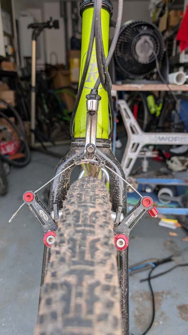

I run 84mm TRPs with modern Shimano levers (more cable pull) and even these are on the cusp of being too close to the rim, I've completely bottomed the lever out in the course of a muddy 80km ride.
I run Shorty Ultimate cantilevers now and they're much better, great.lever feel, good pad clearance, reasonable power.

Shorty Ultimates are worlds different in my experience, but tricky to find at anything other than full (eye watering) RRP.
I fell for some AliExpress knock-offs which didn't even fit over the posts on my frame, lesson learned 😂
It's a cliche but good pads (Swissstop BXP) and careful cable setup makes a world of difference, there's a reason I run cantilevers by choice!
