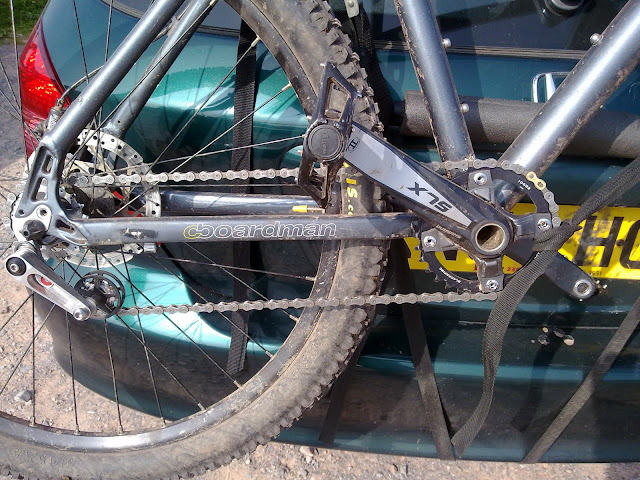

Went over to Exmoor on my day off today and had a near disaster as 30 mins into my ride I noticed half my chainring bolts had fallen out and the remainder were about to join them in the undergrowth. I retreated to Minehead and was directed to Pompy Cycles.
He fished out and sold me some short bolts for a single chainring, lent me tools and I was back riding in no time. It was all my own fault using washers which made my bolts work loose. 🙄 Cheers Pompy. 😀

Apart from my chainring bolt stupidity, the new singlespeeding lashup worked perfectly with no skipping or dropping and just a slight whirr from the tensioner. The bike don't half feel clean without two and quarter pounds of gear equipment on it. I feel pretty trashed tho.

Woohoo - I've got lucky and have been able the dump the DMR chain tensioner.
I was having some problems with it (not well made IMO) when I thought: "Hang on, if I take off the power link plus another link and then use a joining pin, that might be the right length". I was worried it would be too tight, but tried it anyway and - hey presto - it works perfectly without any binding or slipping. Silent running and another few tens of grammes saved. Pity I wasted my ££ on the crappy tensioner; hey ho.
Posted : 04/09/2010 6:58 pm
Posts: 7935
Fair play buzz, theres some proper steep round there!
How will you tension it once the drivetrain has worn in a little?
Posted : 04/09/2010 7:02 pm
I climbed out of Selworthy Combe - now I often run out of gas somewhere on the grassy bit near the top. This time I managed to get to the bottom of the grassy bit before running out of forward motion. Riding back up the road from Minehead was OK with a couple of rests. Another climb up was done in 100m sections with me slumping over the bars and gasping lots (so what's new).
Err dunno. Don't you normally chuck a chain when it's about 2mm stretched? Given that it's quite a short chain, I may chuck it after 1mm which might be in the ball park for tension anyway. I haven't binned the tensioner but I'm not impressed with it. The spring deforms too easily and parts that should be steel are soft ally and get chewed too easily.
