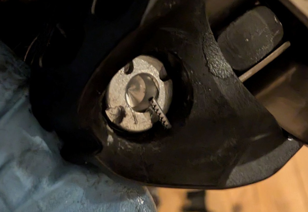

Push the pin out the way then turn the bolt with circlip pliers.

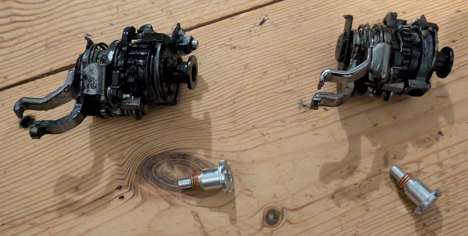

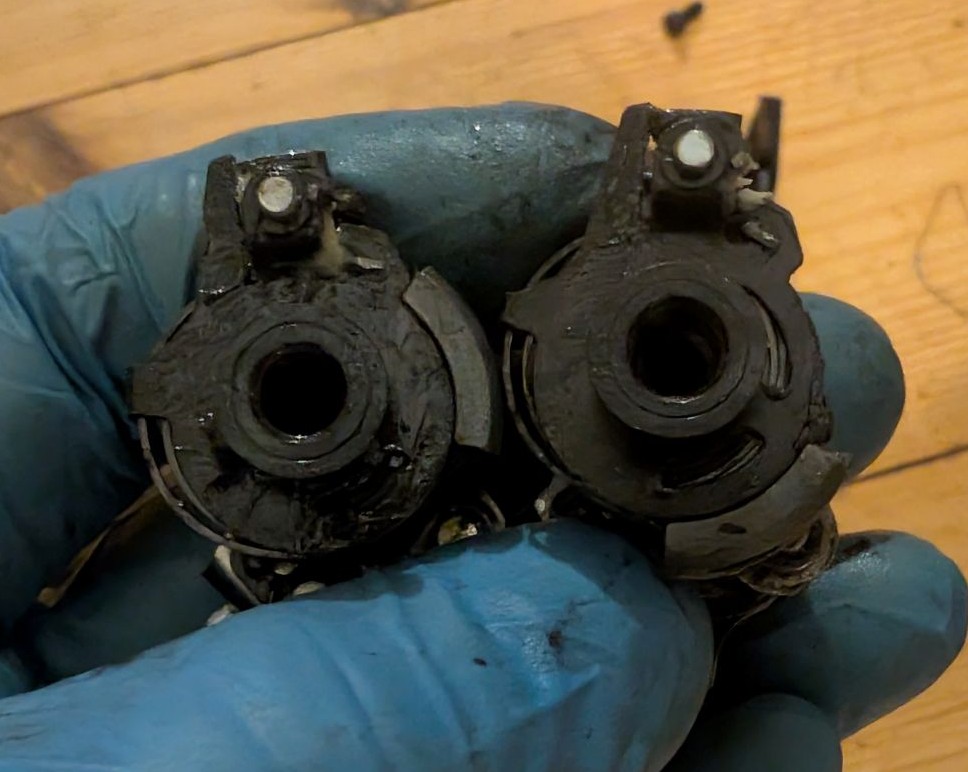

Hmm these look similar... (10 speed on the left, 11 on right)

The apparent difference is just a different gear being selected when I took them apart. It's very simply to put the mechanism back in, the single bolt requires just a few turns to do up and the retaining pins is very easy to move in or out.
So other than my case above where I now have 11 speed grx 400 why is this useful? Mainly because it allows for hydraulically broken 105 or GRX600 levers to be 'repaired' by swapping the index mechanism and lever blade onto the body from a 'cheaper' donor.
