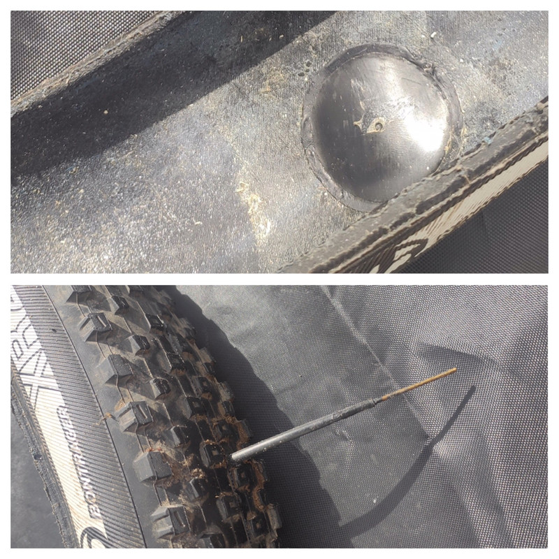

Posts: 17404
One I did earlier.null

Posts: 9995
My photo has a repair on the edge of the bead. As said just trim it down.
Posted : 31/07/2021 7:41 pm
Posts: 17783
Your pic looks just like the one I repaired yesterday Tracey.
Top hole in the edge of the tread and bottom hole in the bead.
Repaired loads like that and all been fine.
Posted : 31/07/2021 7:46 pm
