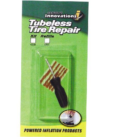

these things are great - seem to be a good long term solution too. You can get a kit with some more stuff in it like glue and a razor blade - if you cut the little anchovies off short they seem to last for years without needign you to take the tyre off and patch the inside.

+1 for wwaswas on the repair strings. They can help seal a big tear on the trail, saving you the indignity of resorting to a tube.

Ta all,
So far so good - not lost any more air.
Looks like I need some of these repair strings - the tyre is a very tight fit so I don't fancy trying to put in a tube on the trail.
