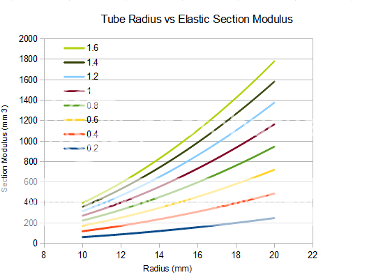

I find a visual representation helps.
The graph below shows tube thickness vs section modulus for various thicknesses. So, at 0.8mm wall thickness, if you double radius from 10mm to 20mm you go from 222 mm3 to 946 mm3, but if you double thickness at 10mm from 0.8 to 1.6 you from 222 mm3 to 394 mm3, or at 20mm you get 946mm3 to 1781mm3.
So doubling radius gives approx 4 fold increase in elastic section modulus, but doubling thickness only gives a double increase in section modulus.
So despite thickness being cubed and radius only multiplied by 4, you have to remember that the thickness is normally only a small fraction of the radius, which is why the radius dominates.
now I've posted this, after 16 minutes when I cant edit, I'll notice an enormous error, so feel free to pick holes..

The graph below shows tube [s]thickness[/s] radius vs section modulus for various thicknesses
idiot..
