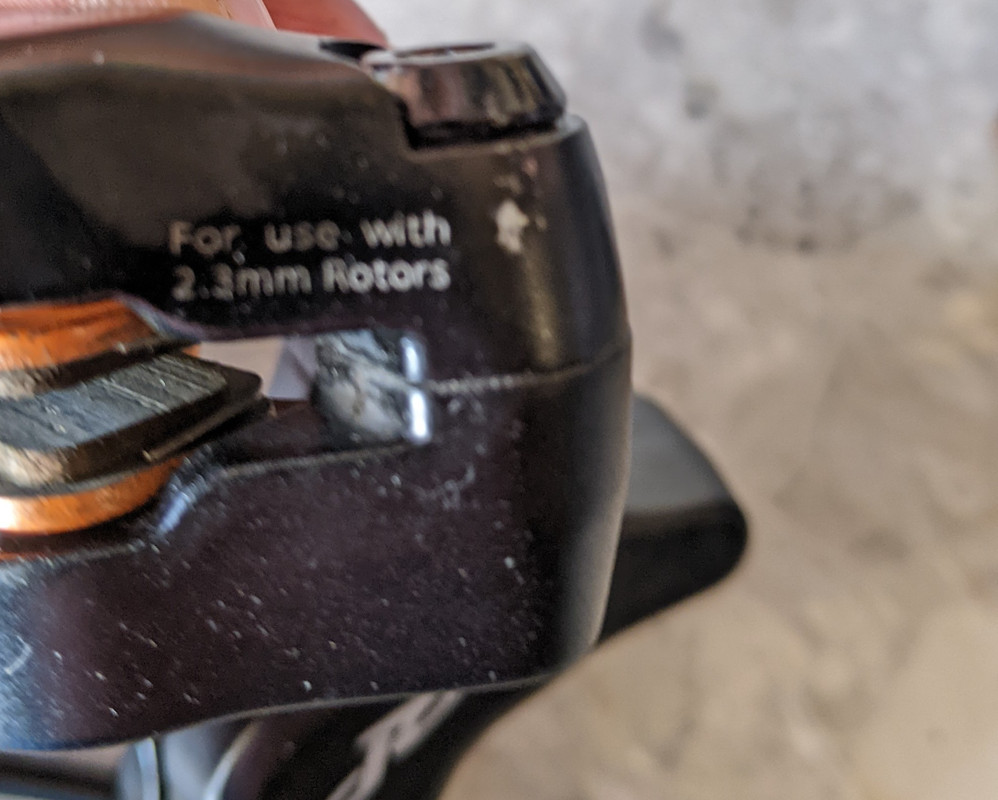

Posts: 7354
My son used them with Shimano rotors and wasn't happy with them. Levers kept pulling to the bars he said.
It does have a minimum rotor thickness printed on the lever body IIRC
He swapped the TRPs out for Saints after a few uses. I would've had them if they'd been ok with the Sram rotors I already had. Oh and the matchmakers. But they weren't so they went on ebay. 🙂
ah no, it's on the caliper - photo was still on my phone
