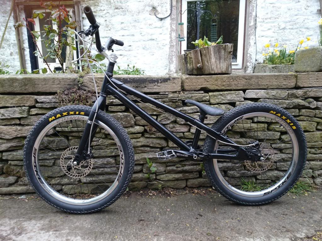

Ah streety street trials. Here's my current street bike for fast flowy type manoeuvres!

It's only a cheap Because Street 24" frame, got it for £40 cause the disc mount had snapped so got a temp fix on until I can either afford another Inspired or get a custom steel frame built up.

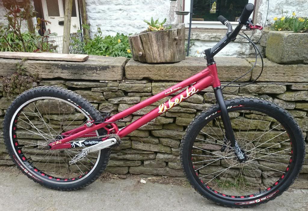

This is my proper trials bike which I am in love with after an awful few months of stuff going wrong!

That is a proper trials bike. Not for me.
I love what I do on it. I broke it. But it cost 300 and I would've paid that for the frame Andy fork so I reckon it has 2 builds in it: This second "get really good" build Amd then the "ultra build".
Frame and fork mean alot.
