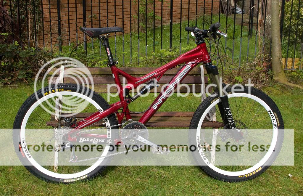

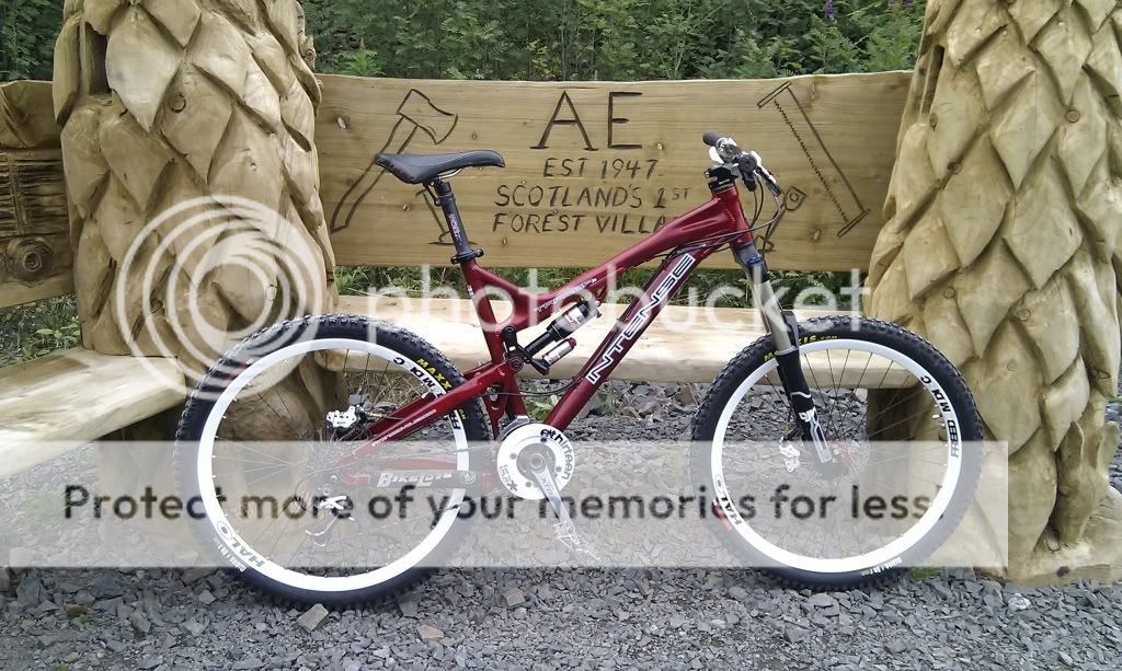

Ive had my Large Tracer for nearly two years... i ran it in the 5" set up for 6 months before changing it to the 6".. i personally think the bike feels much better in the 6" setup and I noticed the diference... climbs amazing for a 6" bike and descends even better.. just Cruz's over rocky stuff and its equally happy to be bombing around natural twisty single track.. excellent bike..

5inch set up
Current 6" Setup
