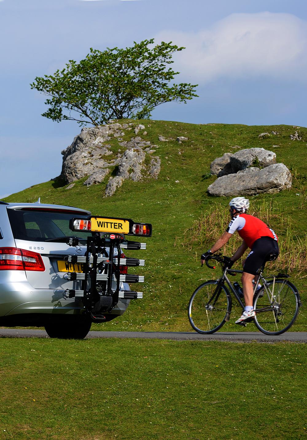

Posts: 324
try a witter tow bar carrier, they fold up on the car when not in use:
[img] http://i1.adis.ws/i/washford/1445011221897c?$imageMainRetina$ [/img]
then down again..
[img] http://i1.adis.ws/i/washford/1445011221897b?$imageMainRetina$ [/img]
they do a 2, 3 & 4 bike carrier... i have one and am very impressed, it tilts completely out of the way for boot access too..

I think the issue of theft of the rack a non issue, but the overhang of the rack and inconvenient when parking is an issue. I tend to only use my rack when on long journeys typically for holidays where I will be removing the rack at the other end or if we're going somewhere as a family where their car parks are not formal car parks so the overhang is not an issue. But for everyday use and normal parking in the street they would be a problem. Most of the time I use my roof mounted racks or have the bikes inside the car.
I would soon get cheesed off removing the rack frequently and putting it in the boot especially with the weight of the Buzzrack.
The Whitter one looks like a nice solution.
