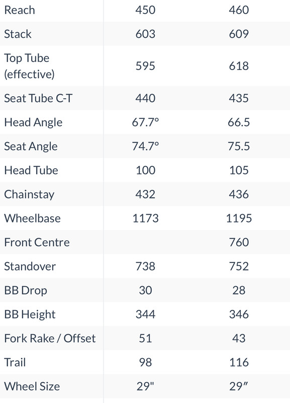

Not sure if this is helpful. But geo between older and newer model:
As someone above mentioned, it might just be getting used to the new geometry. Been riding the old one for 4 years so it’s a bit of a change.
Posted : 12/07/2022 11:11 am

Steeper seat angle and 10mm longer reach, I think both will tip you forward and put more weight on your hands?
Can you measure the tip of the saddle in relation to the BB on the old bike, then adjust saddle on new bike to achieve same position?

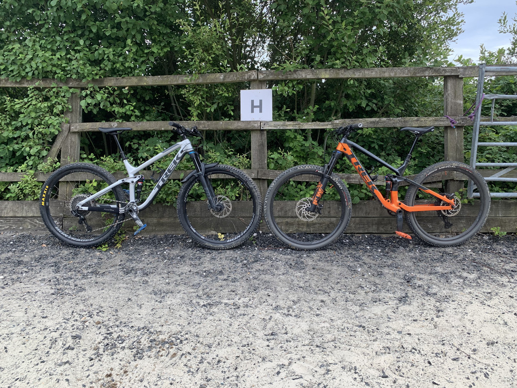

Yeah it might be some more core strength is needed. Few pics, not the greatest but even with the higher rise bar on the new bike the grips are in a lower position to the old bike. There is 10mm or so in it.
I can put the 5mm spacer below the stem. Bars are 27.5mm rise which I thought was plenty and thought front end of new bike would have been higher. But guess the change of geometry has an effect.

Which bike is which, is the grey one or the orange one the new one?

New bike is orange one. Bars are probably level or maybe just below the saddle.
