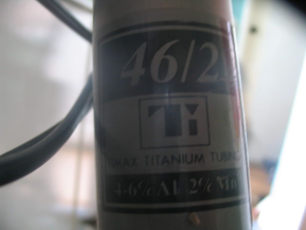

"I wouldn't worry about flat plate dropouts as these ugly beggers are on a 12 yearr old Raliegh and it's built out of Russian chemical tubing - non of this fancy 6AL4V Ti rubbish!"
Interesting..care to elaborate...?? are you talking about OT4-1?? as far as I know they never used that
As far as I remember all Raleighs where made of CP Ti ... and built in house with tubing from Timet.. My memories not so good these days though... All though Justin at WHYTE would be able to reel off a full history!
And Chemical titanium ... ???? 😉 help me with this one?

This is Ot4-1 .... equivalent to 6al4v, but NOT tubes from rolled and seemed plate... This is drawn, variable walled, tapered and ovalised tubes...Raiegh never had this AFAIK !
There is only two machines in the world that can draw and taper this Ti in the style of steel... 😉
As far as the plate dropouts .... you need slot the tube, not too much heat... and know contamination!!! If you can increase the wall thickness at this point it can help with the the issue of welding such different thickness's and heat....
