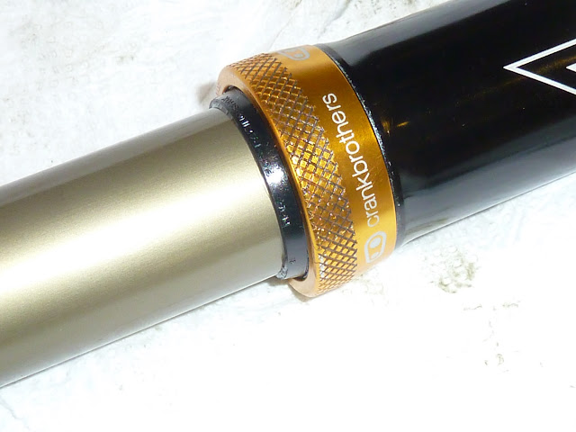

OK - I've tried it again and same result. Took some photos this time. Any ideas welcome.
Original seal installed & no play:
Rp23 seal (on the left) vs the original seal:
I also tried it with (and without) one of the other rp23 seals underneath the one with the lips to make it taller: like this:
Reassembled like this:
Results look like this:
It still rocks forward and back. Anything obviously different to you guys?
Posted : 28/11/2011 1:57 pm
not the same seal as mine
Posted : 28/11/2011 4:46 pm
my seal is virtually the same as the original
Posted : 28/11/2011 4:48 pm
Thanks Cruzheckler - that explains it.
The fox seal was exactly the same as a new one from a service kit so it looks like my Joplin 4 is a bit different to others - maybe model year or something.
Appreciate the help!
