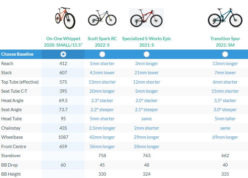

I'm not seeing what you are seeing... Your Whippet isn't that old, so quite in the middle of reach numbers. There are bikes with longer and shorter seat tubes.
https://geometrygeeks.bike/compare/on-one-whippet-2020-small-15-5,scott-spark-rc-2022-s,specialized-s-works-epic-2021-s,transition-spur-2020-sm/
Posted : 08/12/2022 11:51 am
Posts: 4411
If we compare the Whippet and Spark above, which would feel shorter?
The Spart has 1mm less reach, but 4.5mm lower stack, and seat tube is a fair bit steeper. My Whippet feels fine but wouldn't want to go any shorter.
Stood up or sat down?
Posted : 13/12/2022 4:01 pm
Posts: 4411
Both.
Posted : 13/12/2022 4:14 pm
Posts: 6581
I'd say they'd feel about the same stood up, the Scott would feel shorter sat down
Posted : 13/12/2022 5:13 pm
 5lab
Posts: 7926
if the reach is similar and the seat tube steeper you'll be more upright seated.
Posted : 13/12/2022 5:33 pm
Posts: 3386
We’ll as the Spark has a shorter TT and Reach it would most likely feel shorter both sat down and stood up
Posted : 13/12/2022 5:43 pm
 5lab
Posts: 7926
if you can feel a 1mm difference in reach you're a lot more sensitive than me.
Posted : 13/12/2022 6:44 pm
Posts: 4411
I wouldn't notice 1mm. Don't think anyone would. Looking at Mondraker job as they have short seat tubes so I can fit on more sizes.
Posted : 13/12/2022 7:26 pm
Posts: 9839
The Spart has 1mm less reach, but 4.5mm lower stack, and seat tube is a fair bit steeper. My Whippet feels fine but wouldn’t want to go any shorter.
If both bikes have the geometry stated when static the Spark is shorter. The Whippet will sag at the front only, reach will be longer then + STA will be steeper. If the whippet is a sagged geometry then the comparison is more er, comparable.
