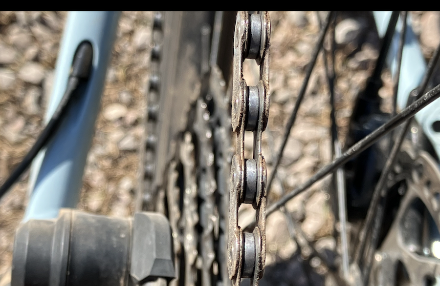

Just moved from MucOff wet lube to Synergetic.
Chain fully cleaned/degreased. Applied the lube, ran the chain backwards with my fingers on the rollers.... then wiped off with a microfibre cloth.
This is what it looks like now. I'll post another pic after my 15 miler today:
Posted : 05/04/2025 8:12 am
 Oms
Posts: 265
...and after 15 miles on hardback at FOD today. The rollers are very clean. 👌
It's the outer links that have dust stuck to them.
The question is whether it's because I used GT85 to drive the water out of the chain (it had been degreased, then washed) because I didn't have my air compressor handy.
I'll post up another pic in a few days after riding the same  route with the same lube, but using my air compressor to blow the water out of my chain after cleaning. May as well have a go for science.

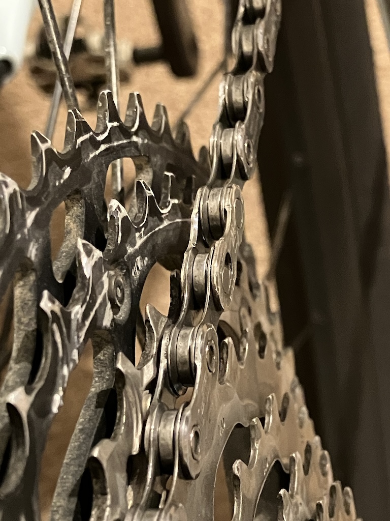

Just an update (forgot to take pics):
I started again, degreasing, blow drying, applying as instructed; then riding the bike.
I wiped off the excess that oozes out after each ride with a microfibre cloth (12-15 mile dry rides), also paying attention to the chain ring and jockey wheels.
After the second ride and wipe-down, not much came out at all. The chain (and drivetrain) looked suspiciously clean and shiny after rides 3 and 4. I almost re-applied the lube because I'm not used to seeing that, but I resisted.
5th ride (12 miles) was very wet - a ridiculous amount of standing water that completely soaked me, the bike, filled my shoes etc... Zero squeak/noise/grinding from the chain.
Obviously after such a wet ride, it was given a thorough clean and re-lube.
It certainly does seem to last - wiping off the excess in-between rides definitely helps. 👍
