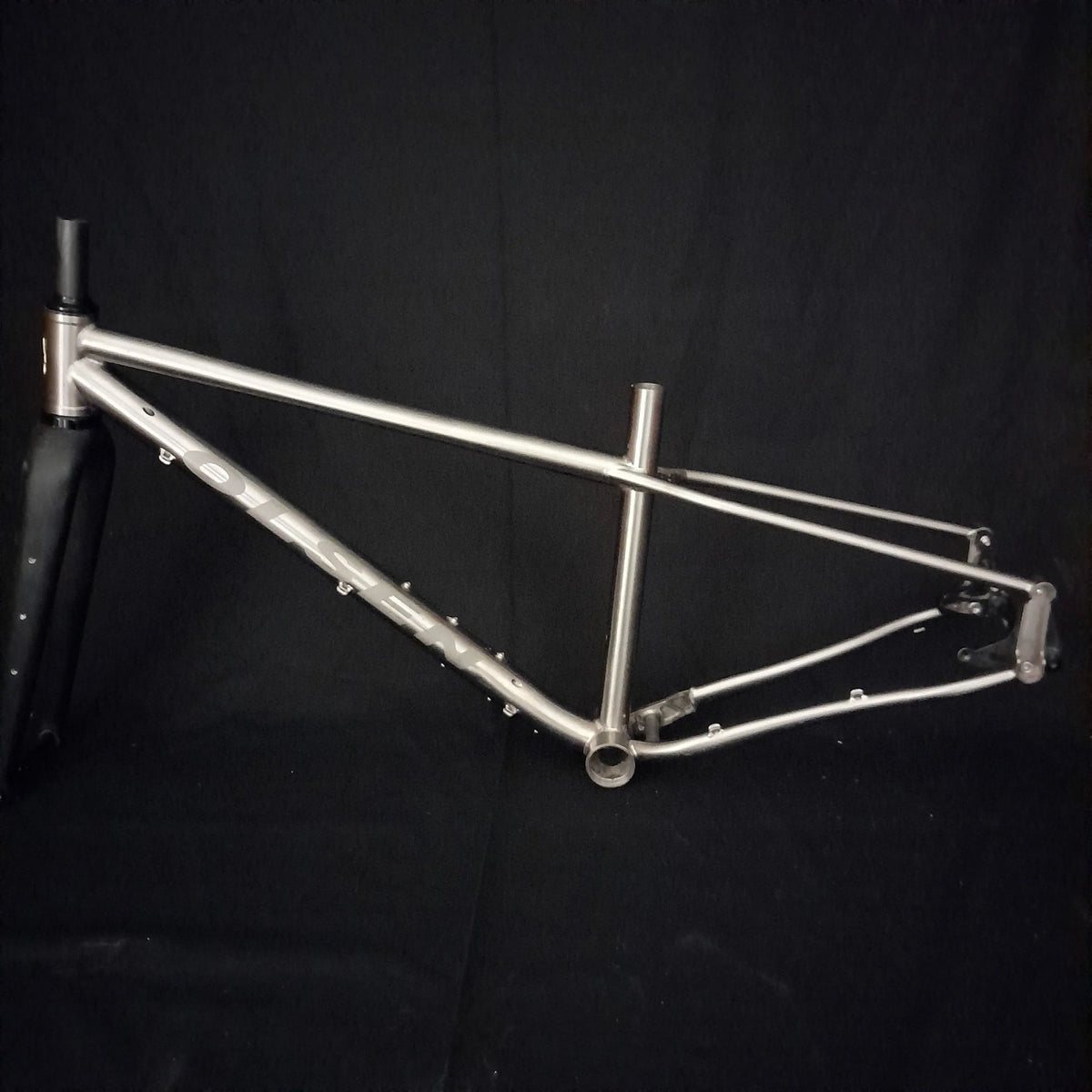

The Ti olsen Swan frame at banana industries?
https://www.bananaindustries.co.uk/products/olsen-bikes-ti2-swan-mokahini-large-frame?_pos=2&_sid=2e43d5db3&_ss=r
Posted : 10/09/2025 7:29 am
Posts: 491
142mm rear spacing would put me off the Olsen bike, unless building it into a monster gravel
Lack of rack mounts rules it out for the OP's purpose.

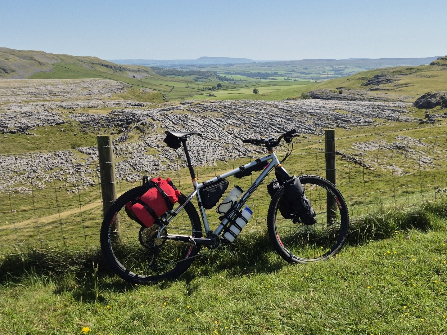

I missed the bit saying you wanted photos!

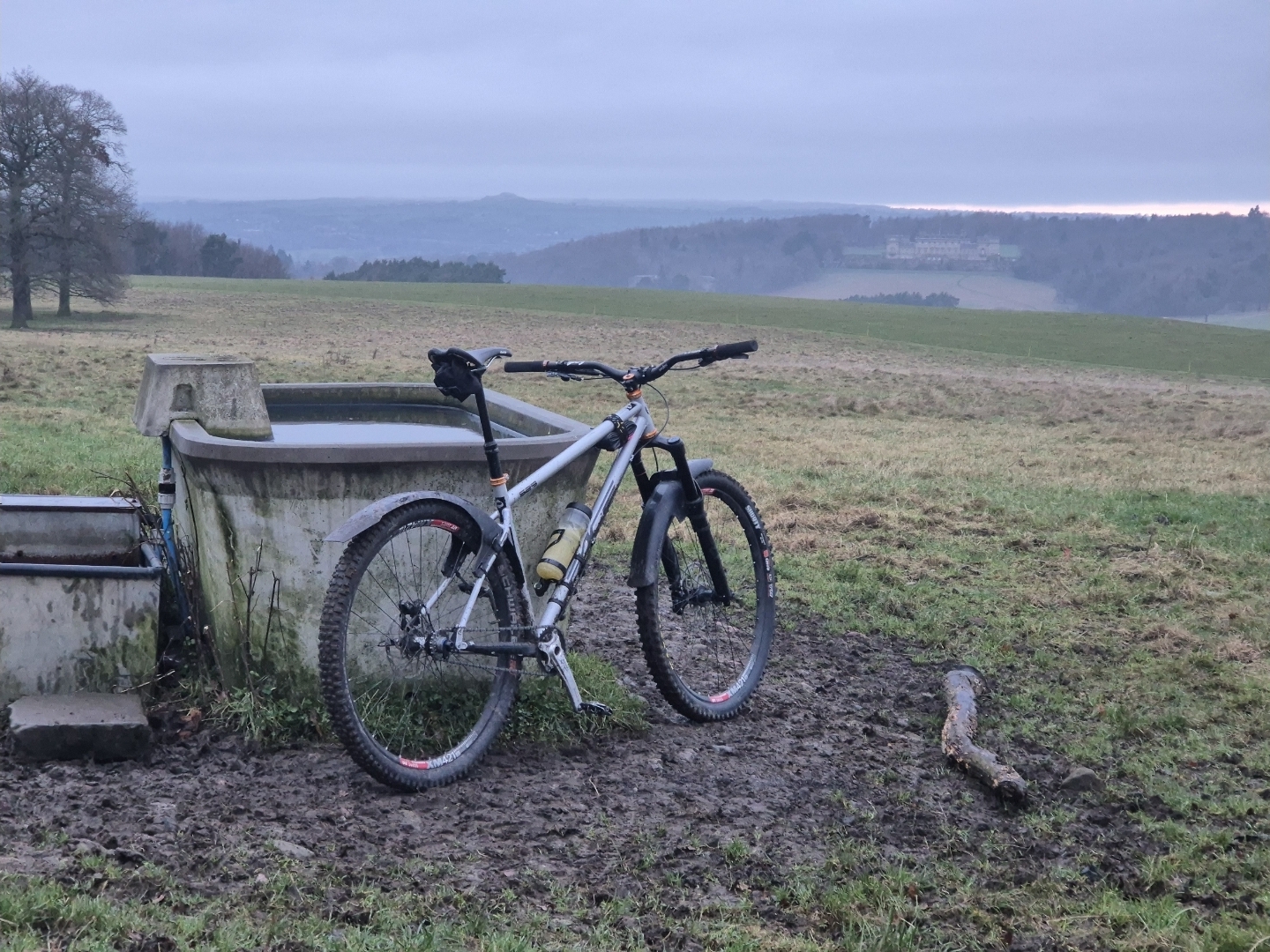

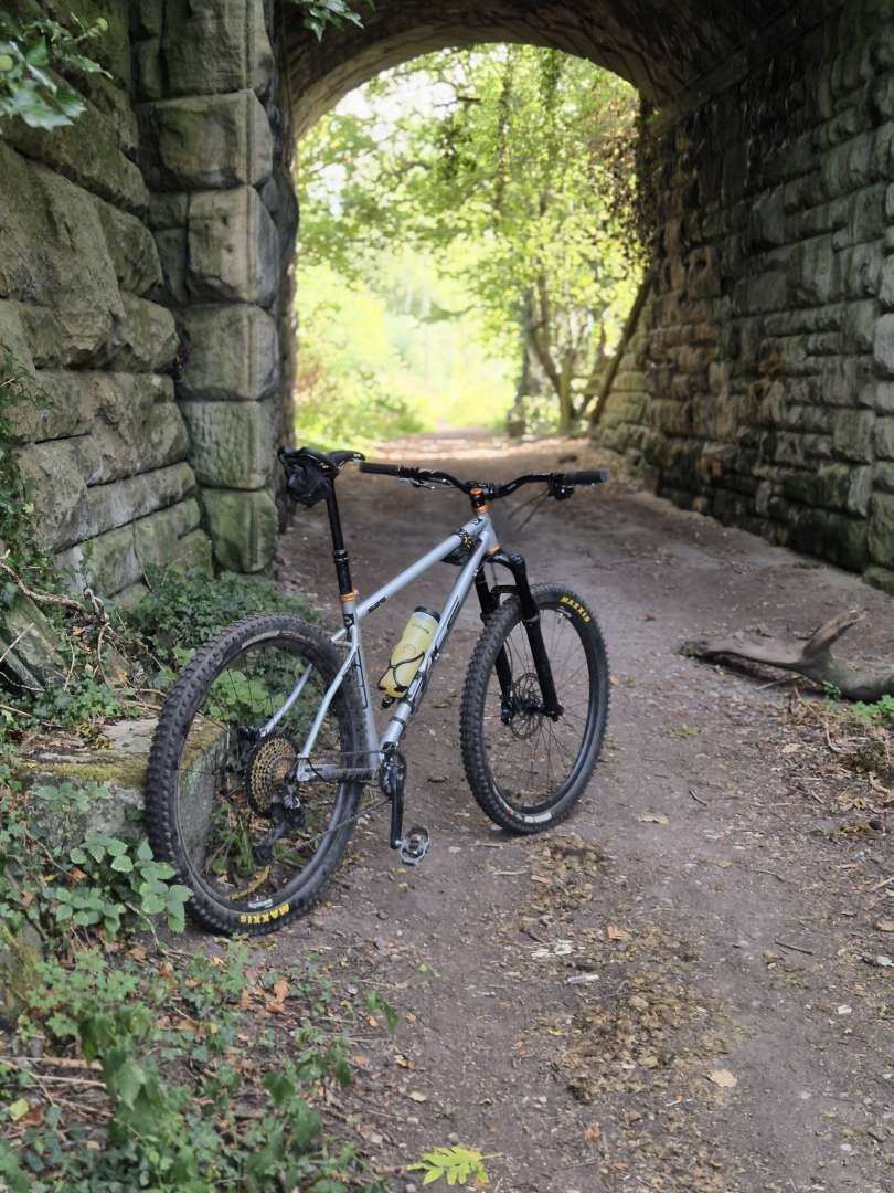

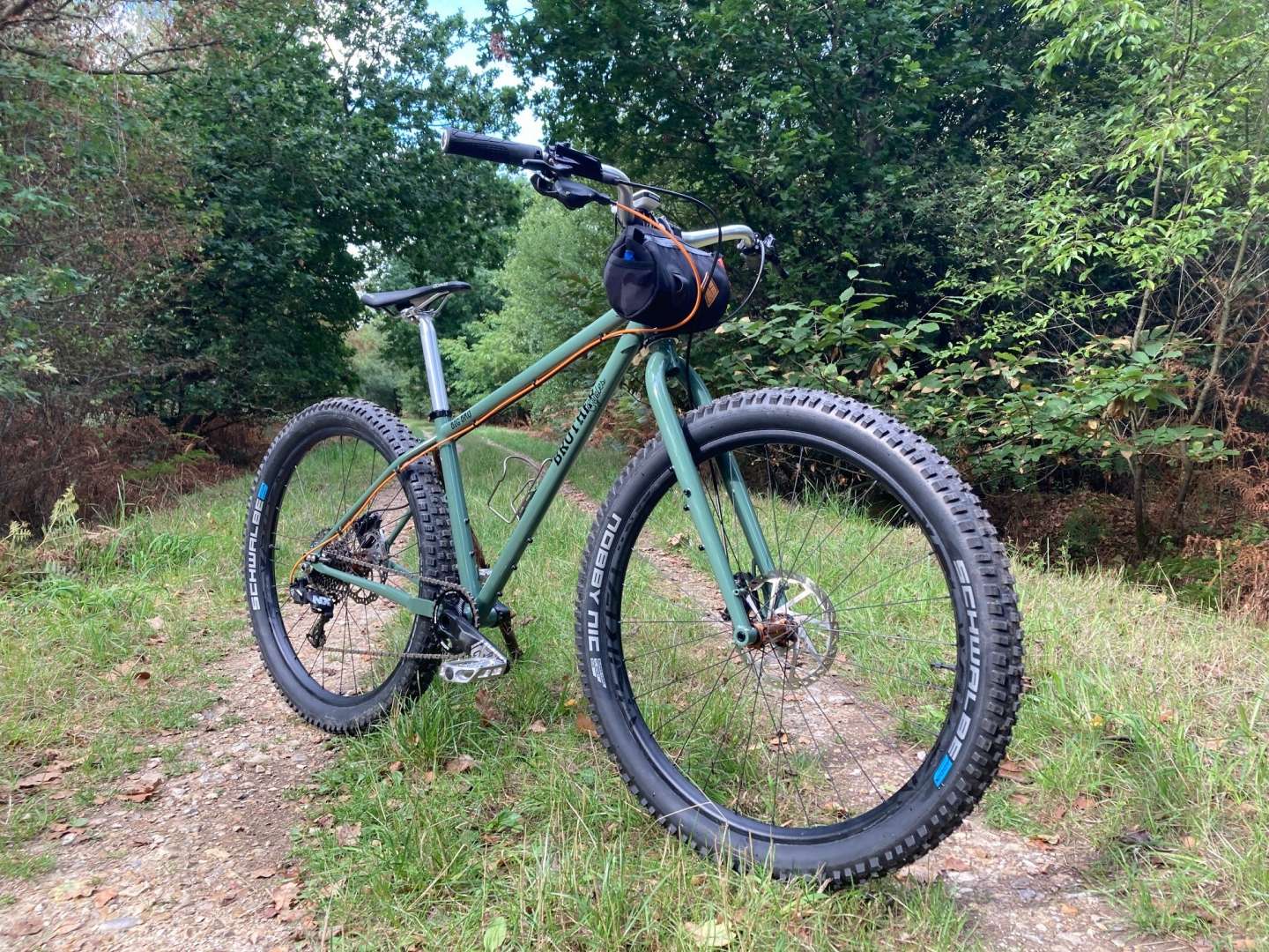

Pace rc529 also works for this. More enduro/trail than the 429 (which is more xc) however the 529 still comes with rack mounts and is great built up as a rigid bike packer too. Also has slidey dropouts for singlespeeding.
Well happy with mine. Super versatile and rides great.
Screenshot_20250912_185109_Photos.jpgScreenshot_20250912_185256_Photos.jpg20250828_090938.jpg

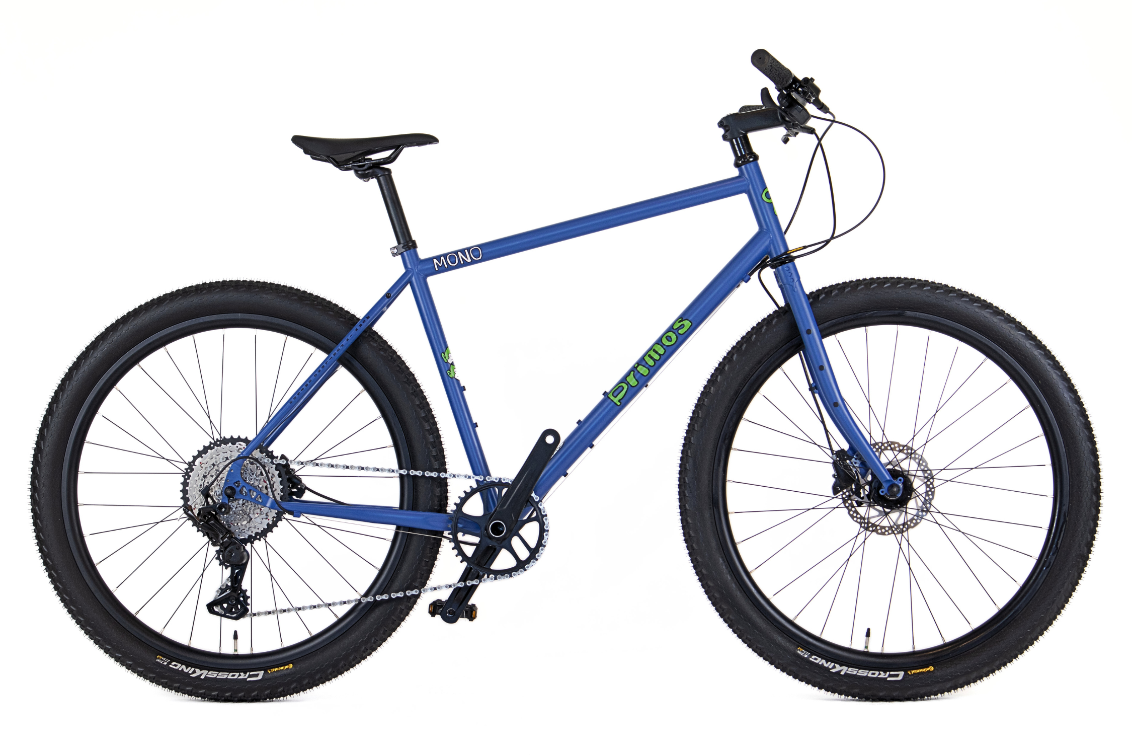

Ready to roll.
https://primoscycles.com/products/mono-bicycle?srsltid=AfmBOorW-9JE6rPGZg8SlRw09VoN_gBN1bOZCxllHxLB-RUAavGkISCc
id prefer the option to run at least 27.5+
im not sure whether Planet X are going to discount their ‘big dog’ frames.
how well are their bikes aligned nowadays?
