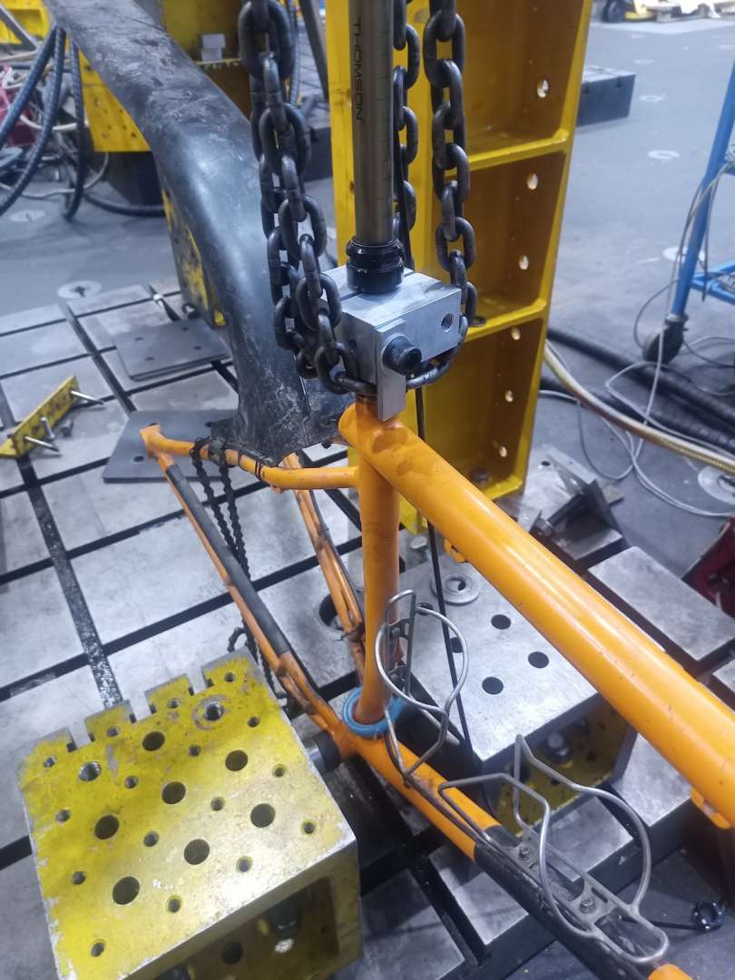

Posts: 3643
If properly stuck, then the only non-destructive method is to pull it out with some kind of tool e.g. seatpost man at Chorley or the various tools shown in YouTube videos. It can take 1-2 tonnes of force.
I made a clamp block just a couple of weeks ago to remove my stuck dropper before Jennride. Luckily we have a 10 tonne crane and strong floor grid at work so pulled it one lunchtime.....
Posted : 12/06/2025 10:30 am
