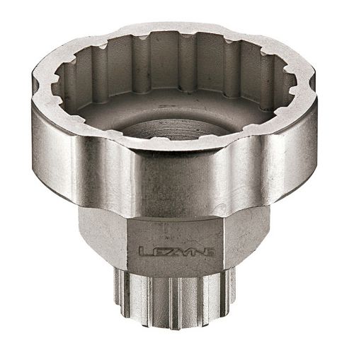

So - can anyone recommend a particular cassette tool with decent teeth and engagement that suits XD cassettes (and Hope hubs, mainly)?
My old BBB one has done the job for me up to now, but it's a cheap tool, and I'd be happy to shell out for a decent one
Posted : 27/04/2016 11:08 am
Park FR-5GT if you have 12mm rear axle
Posted : 27/04/2016 11:14 am
Posts: 13850
blairc70 - Member
I have a mixture of different axles.
The Lezyne one looks good in the pics, anyone used it?
[img] http://media.chainreactioncycles.com/is/image/ChainReactionCycles/prod73442_Silver_NE_01?wid=500&hei=505 [/img]
