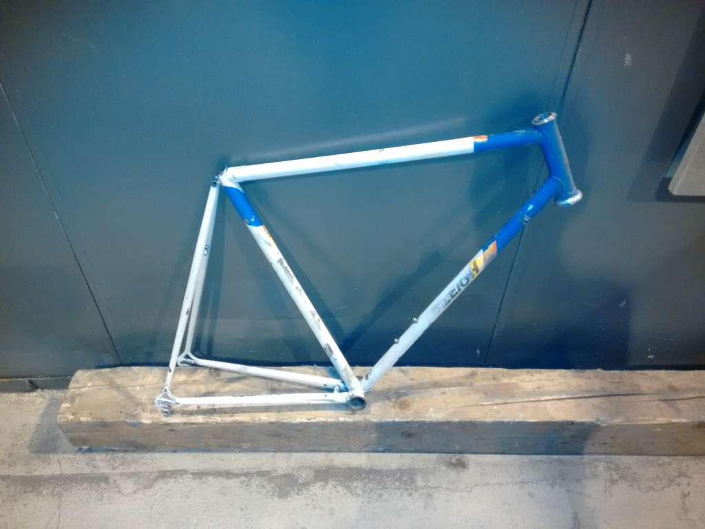

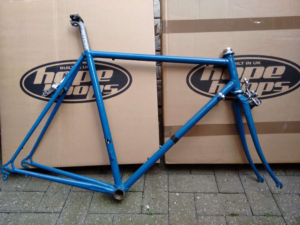

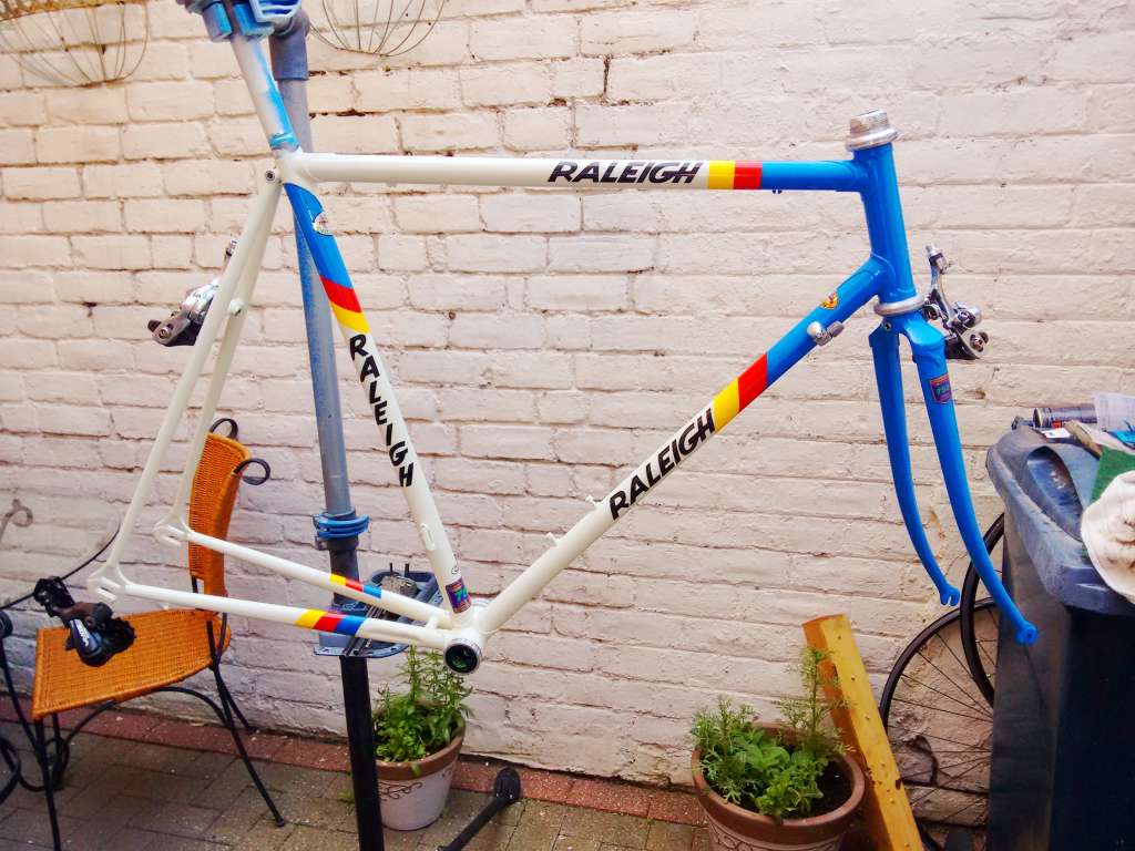

Posts: 978
Did this a few years ago with rattle cans. Despite letting it sit for over a week beside a warm radiator, the paint wasn't very hard wearing.
First ride out, the QR slipped, and the tyre took the paint straight off the inside of the chainstay
Decal/sticker kit from someone in Australia
Team Panasonic 753 steel
Before
IMG_20150411_093520
During (nut blasted at work)
IMG_20150418_120758
After
IMG_20150523_161651
Posted : 06/10/2023 8:53 pm

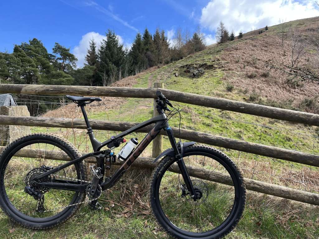

Posts: 12648
how durable is spray.bike?
Looking at the state of my bike, not very. Admittedly it was a fixed gear crit racing team bike but the whole rear triangle is a complete mess (far worse that it looks in this photo)
Posted : 07/10/2023 7:18 am
