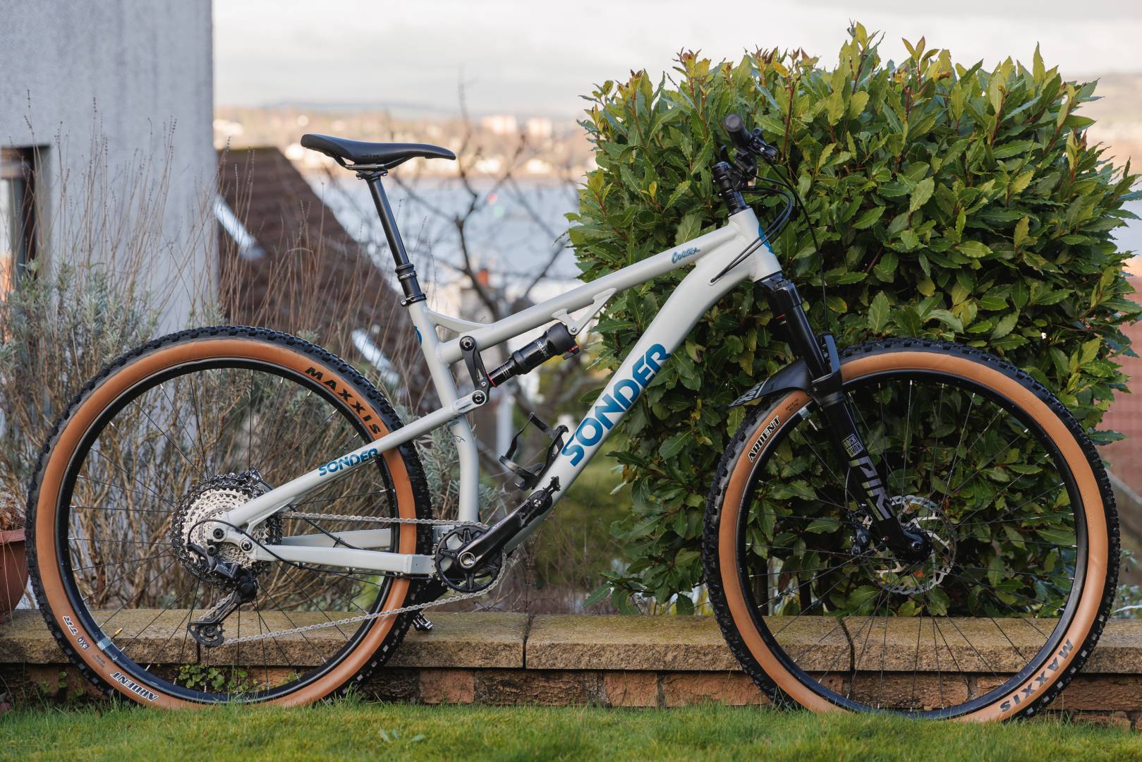

I started the build today.
Ran all the cables and hoses.
Stripped the 23 Big Al, the donour bike.
Couldn't insert the dropper which fits nicely without a cable but the outer snags onto something in the seat tube that chews the coating of the outer. Went through 3 outer cables with the same result despite "trying everything". I even bought some small round files to file any burrs that have been left after the hole was drilled (which I am pretty is the problem), but to no avail. There is a bend so I can't see from the top even with a torch light.
I contacted Sonder who sounded friendly but haven't come up with a solution.
Any ideas?
I know it was cheap at £350 but it's actually quite expensive as useless.
I seemingly bought the last one so not sure what's gonna happen. I bought bits for it, applied frame protection etc.. plus headset and new forks.
Tough situation. Hopefully they will do the right thing, whatever that is.
A bit pissed off by the absence of QC so apologies for the rant.
Posted : 27/01/2025 10:49 pm

^ Thank you. I can do that too but when inserting the dropper the outer snags as its trajectory is determined by the fact it's attached to the dropper as oppose to being able to go around any "obstacle".

The problem is that this is what happens to every outer despite the utmost care. It literally chews the outer. I am pissed off enough like that without spending yet another £20 for potentially nothing. It's a clear warranty claim that Sonder is refusing to honour.
[url= https://i.ibb.co/0jbZNGBN/IMG-20250127-140207.jp g" target="_blank">https://i.ibb.co/0jbZNGBN/IMG-20250127-140207.jp g"/> [/img][/url]

Finished. I managed to transfer everything across from the old frame minus a headset and an inner cable which is a record, I think.
Posted : 07/02/2025 5:03 pm
