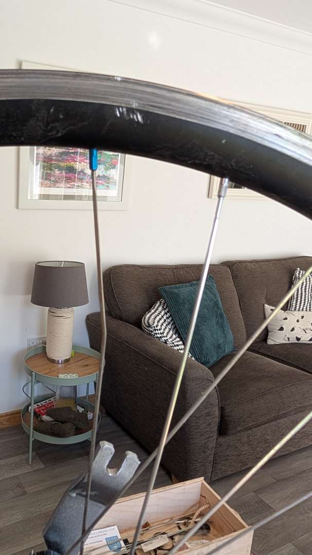

However maybe the smoking gun was this beauty, immediately adjacent to the one that snapped. Clearly a rock strike or something. Wondering what effect a spoke with a visible kink whilst under tension (photo is with tension wound off a bit) would have on neighbouring spokes...

With rear wheel builds it’s often a case of getting the drive side to true and evenly tensioned and the non-drive is just what it takes to keep it true - trying to get all three together is often just chasing your tail. Add super-stretchy spokes into the mix and it gets even more fun, with a light and flexible rim it’s fun, fun, fun. 🥳
