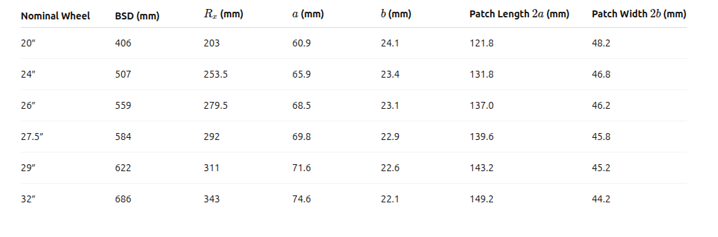

I think we've talked about this before but the change in contact patch shape as you change the wheel size is something that I definitely disagree with.  In fact, I did the calculation recently (or rather, I got ChatGPT to do the calculation) an in order to reduce the length of the contact patch of a 2.5" tyre on a 29er wheel by 1mm you would have to reduce the outer diameter of the tyre to something like 90mm.  So basically get rid of the rim, spokes, and hubs.
I'd really like to see some proper head to heads of wheel sizes where the wheelbase, chainstay length, BB height (not BB drop), front normal trail, RAD distance, and RAD angle were all kept the same and the only difference was the wheel size.  Obviously use same tyres, same tyre pressure, etc.
Then, if it turns out the vast majority of the change is coming from the geometry and not the increased wheel diameter then just start making 29er bikes with the better geometry and don't give us a new wheel size standard (which is going to result in new hub standard, which is going to result in a new crankset standard, etc).

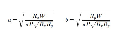

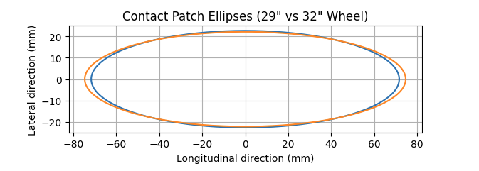

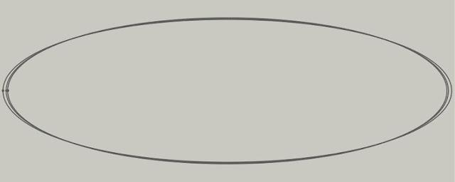

"...the change in contact patch shape as you change the wheel size is something that I definitely disagree with.  In fact, I did the calculation recently (or rather, I got ChatGPT to do the calculation) an in order to reduce the length of the contact patch of a 2.5" tyre on a 29er wheel by 1mm you would have to reduce the outer diameter of the tyre to something like 90mm.  So basically get rid of the rim, spokes, and hubs."
So, that disclaimer about ChatGPT giving wrong answers...
The shape of contact patches being linked to tyre geometry is not some pie in the sky marketing creativity, it's a long established part of pneumatic tyre design. Even basic intuitive analysis (assuming you understand enough maths/physics/engineering) confirms it.
Regarding the why of 32"? It might win XC races where tiny margins happen. People like buying new things so if you're tooling up to win races you might as well sell products on the back of it. We know 29" tyres have plenty of pros (and some cons) vs smaller tyres, so it's not rocket science to extrapolate to a 32" tyre.
Not sure why people are saying it's the same size as a 29+ tyre - few of them are over 3" nowadays, so little over 30" diameter. 26 is 559mm, 27.5 is 584, 29 is 622, 32 is 686. So that's steps of 25mm to 27.5, 38mm to 29, and then 64mm to 32. It's MUCH bigger.

Using Pressure = Force / Area we know that in the steady state (riding along a smooth surface in a straight line) the area is the same regardless of the radius of the wheel.  The area only changes if you change the force applied.
So then we come to the tyre geometry.  There are two measurements we are concerned with, the radius of the wheel and tyre and the radius of the cross section of the tyre (for our simplified model we will assume the cross section of the tyre is perfectly round).
The shape of the contact patch is an ellipse and a and b values of the ellipse can be calculated with this equation:
where Rx is the radius of the tyre cross section, Ry is the radius of the wheel and tyre, W is the load, and P is the pressure.
I don't think STW supports Latek so it's probably not the best place to show the full derivation.
So, if we have a 2.5" tyre inflated to 20 psi, here is a table of the shape of the contact patch for various different wheel sizes:
Obviously, from there you start looking at things like lateral stiffness vs longitudinal stiffness, actual cross section shape, deformable ground, tread, etc so yes, it gets very complicated.
However, all these factors are independent of wheel diameter.  If you want to say the contact patch shape changes with wheel size then yes it does, but you have to show how this factor can only be applied to larger wheels.  Remember, the largest proportion of the contact patch is in the centre so while the contact patch length seems significant, the actual effect is going to be minimal.  And the changes to contact patch width are very very small.
At least, that's my attempt at putting some maths into it.
By the way, I know I said the change in contact patch was barely observable earlier but that was based on a rectangular contact patch which is probably OK for car tyres but not for bike tyres.

RE contact patch shapes,
We can look at a change literally as the maths % difference but it's useful to also look at it as a percentage of a workable or normal range. So a 69 to 67 degree HTA change is perhaps 20% if the workable range is 10 degrees. I don't know what a workable contact patch shape range is but they may have a total length range of around 100mm for all bike types. If it is 100mm, for MTBs it may be 50mm and the 29-32 contact patch length change is then around 10%. Still, doesn't really help me if I can't put a quantitative into a qualitive sense (I can feel grip or steering lightness vs flop, but not contact patch shape)
I've got a few sheets of paper here with tyre prints on them. Not for the contact patch variations bc all the tyres and pressures vary, but it's useful with steering geometry references for each bike. I take the prints sat on the bike at the tyre pressure I find is about right after riding the bike, often taken at 2 workable pressures (and I realise my CoM on and the geometry of the bikes vary and that affects front wheel weight a bit)
The 32" Maxxis Aspen contact patch at riding pressure vs a similar format bike (diff geo but very similar weighting and position) with Ikon 29" tyres at the same pressure and the front patch was about 15% longer. To get either 32" or 29" wheel in this case to change by that ~15% I had to change the pressure by a similar %. 20psi down to a bit over 15psi or VV. The 32" Aspen is a very light casing which will affect things, but it's pressure that makes most difference and that's how we set our bikes up. It's worth remembering that the impressions we're hearing of the 32" format so far are based on one very supple and light tyre (remember light Plus tyres and how that went?).
The other aspect of this I was thinking about is how this isn't a track bike on a perfect surface. An MTB wheel engages the ground with a lot of variation or 'noise' at the leading edge. A 32" wheel has a shallower angle of attack, on average terrain that increases the size/area/effect of that noisy front edge. Plus, the timing of a bump is also changed by the wheel OD, more rotational ange from rolling on to rolling off i.e. a bit more time but the same bump height. These 2 points combined might give an impression of a longer patch or a feeling of 'more wheel in contact with the ground'.
Similarly, when I went from 26 to 29 I rode 29" Ardents a lot (2.25 and 2.4) and I remember thinking they gripped well on mixed damp surfaces. Then after a while I accepted they weren't great tyres for the Chilterns and got better treads. Yet the impression was that they gripped well vs my old 26" that had my pick of decent tyres. (casing quality, remember that too)
Riding that 32" bike made me think of my 'grippy Ardents' impression. Aspens are not grippy tyres but no doubt they were doing a far better job than I first expected. Over a longer ride I began trusting them on wet or muddy corners and off cambers, straight-lining a deep soft section at speed was very predictable too. Climbing was easy but I'd say that was mainly the weight dist and geometry, still, the tyres coped on soft muddy gully bits of relatively steep climbs.

I agree that small changes can make quite large differences, but if we are talking about the change to the shape of the contact patch I'm really struggling to see how it could be noticed.  Going back to the image I posted above for the same tyre at the same pressure on 29" and 32" rims:
Here we have a 4.2% increase in contact patch length and a 2.3% decrease in width for the 32" vs the 29".  It sounds like a reasonable amount but this issue is that we are talking about an area rather than a length, so any difference (or lack of it) is going to be squared.  It's kind of tricky to quantify a change in shape if the area is constant but one method is to take unshared area as a percentage of the shared area (ie, the extra longitudinal area plus the reduced lateral area).  Doing this gives us a change in shape of only 1.3%.
Just to put that in perspective, if we wanted to increase the overall size of the contact patch by 1.3% we would reduce the tyre pressure from 20psi to 19.74psi.
Small changes can make a big difference but with the changes in shape we are talking about here I really don't see how it is detectable.
I think the issue with changing wheel size is that it is impossible to keep everything else constant.  You can try but there are always going to be differences.  My issue with the wheel size debate is people feel and sometimes even measure a difference and attribute that to the increased diameter.  They don't take into account that even if you just swap to a bigger wheel you have changed the front normal trail, the rear normal trail, the flop, the stack, the reach, the wheelbase, the front centre, the rear centre, the BB drop, the BB absolute height, etc.  And that's before you even turn the handlebars and change all those numbers.
Basically, you can't say if the bigger wheels are the cause of the improvements until you have managed to recreate the trail figures, weight distribution, and body position on the old wheels.  And that's going to need a completely new frame and probably a new fork at the very least.
Wheel size debates always feel a bit like cargo cult science.  Bikes with bigger wheels have more grip/handle better so therefore if we can get big wheels we will have more grip/better handling.  My argument is that if you can't quantify exactly why you have an improvement then maybe the wheels are better or maybe something else caused the improvement. If you could figure out exactly which aspect of all the geometry changes you've introduced with the new wheels and then apply them within the confines of the current standards, rather than introduce a whole slew of new standards maybe you'd find you don't need new wheels at all.
Or maybe there really is something special about bigger wheels.  However, whatever it is, it is not the change in the shape of the contact patch, based on the maths.
