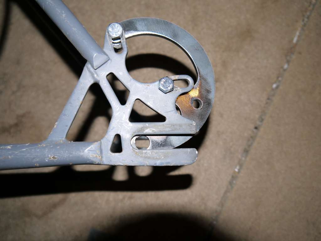

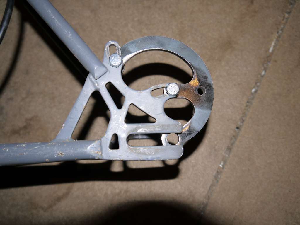

Posts: 3641
You can get away with a small amount of adjustment but just need to watch for the caliper rubbing the disc or unworn parts of pads bottoming against each other.
A slotted IS to pm adapter could be made if you are handy with a drill, saw and file. An arced slot design gives approx double the adjustment (eg 10mm slots allow 20mm of wheel movement).
Photos are of a slotted dropout not adapter but gives an idea how the arcs work (the horseshoe thing is my dropout jig that shows the IS alignment).
P1030926P1030925
Posted : 04/02/2024 12:44 pm
