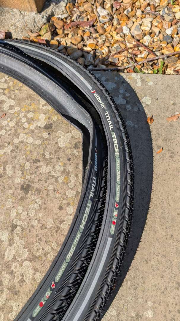

Posts: 7997
 PXL_20250824_092009230.MP.jpg here you go Vittoria trail tech.
OK thanks, very much appreciate the offer and they definitely look robust, but I might have to draw the line at 900g per tyre! 😎

Posts: 7997
😱 Is that what they're supposed to weigh! sorry I had no idea they were that much!
No wonder I only did one ride on them 😂
I sense they may be headed for landfill at that weight.  😬

Posted by: garage-dweller
Haha, no bother, I didn't stipulate a maximum weight 😂
