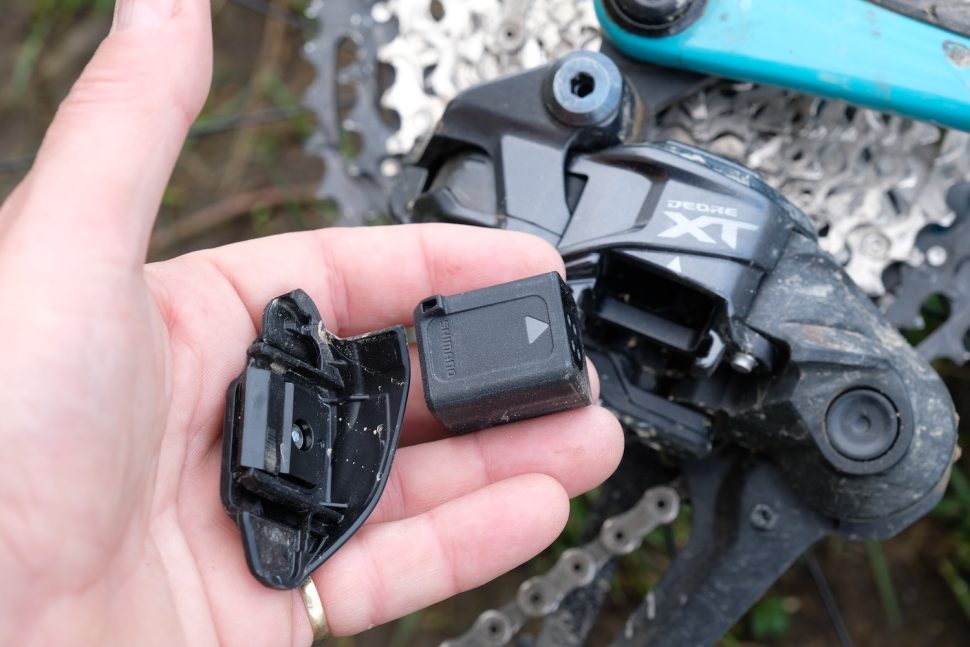

I've had this on the eeb since December and really like it. So much so I'm considering getting another set or maybe the deore version for the other bike. The only potential issue I've noticed is the battery compartment not being fully weatherproof although the dirt doesn't seem to infiltrate the top area where the contacts are.

The other benefit is the battery last ages. Like 10x the SRAM. Im guessing that part of this is down to it only waking up when you shift, it's not wasting battery in the back of the van or whenever you move the bike around.
