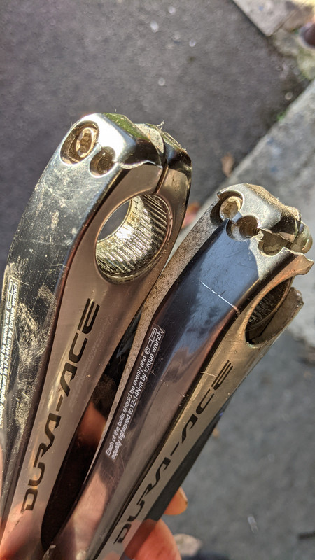

As on the other thread about this - I only kept the delaminated arms. Sold the rest on, so not sure if they'd warranty me.
But was bloody annoying to have 2 go like this

Before I either embarrass myself at the LBS or kill myself by continuing to ride, would a more experienced rider cast their eye over these photos of my chainrings? They're in the recall batch, but I can't tell if I'm just looking at the normal interface between the two chainrings, or whether this is a crack.
- Looks buggered to me!
I’ve got two sets and both look fine to me but I’m just a rough arsed chippy and not an engineer.😀
Although I definitely would say that set ^^^ is in need of a replacement!!
