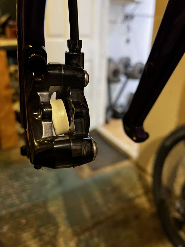

Ffs - didn’t realise the bleed block had fallen out when doing the front brake and This is the result:
IMG_4492
Didnt seem to be cracked so pushed it back in and isn’t currently leaking. See if it’s still dry in the morning. If not I’ve just cocked uk a brand new caliper ffs. I hate the brakes on this bike.
