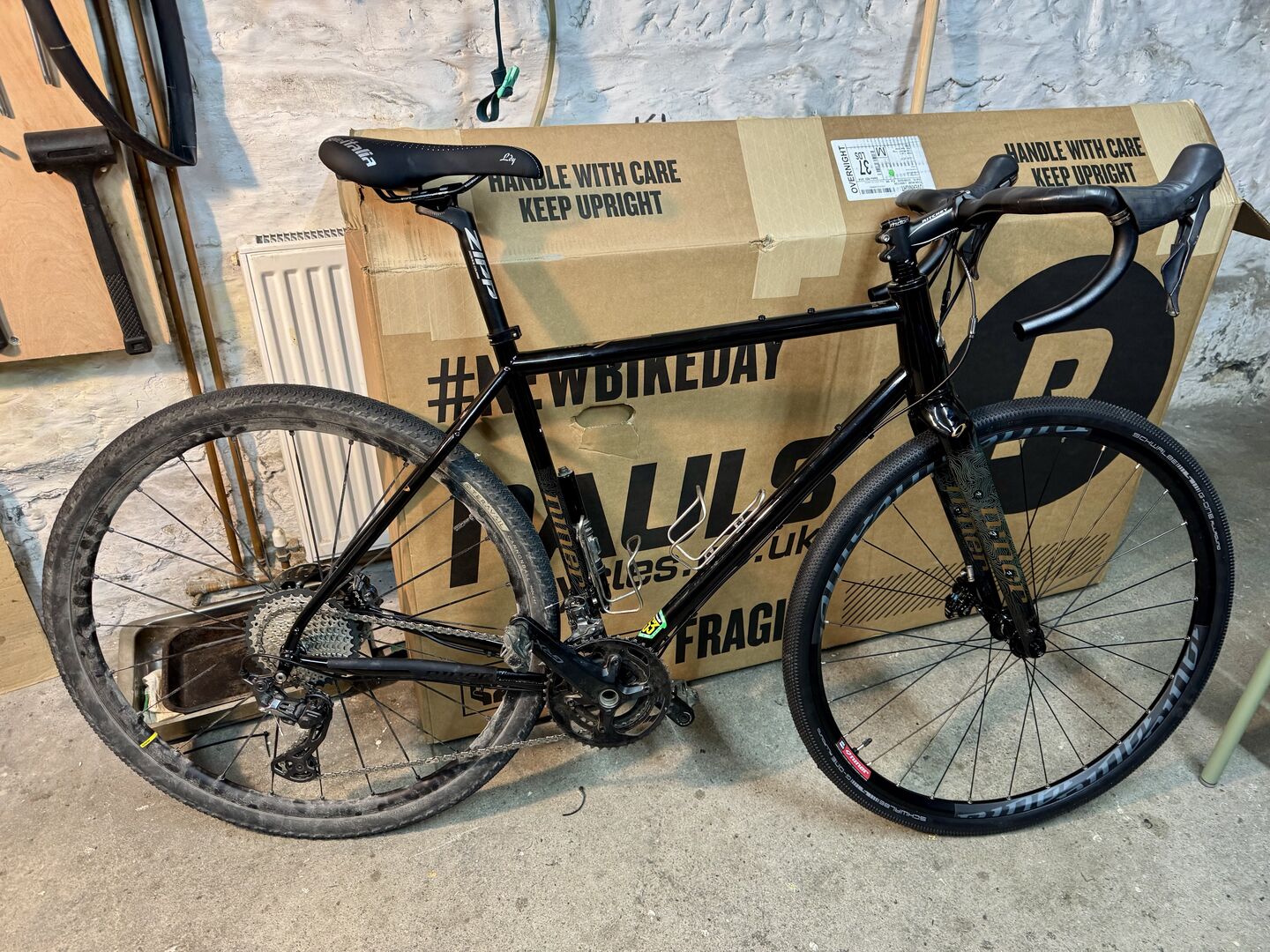

46/30 and 11-40 works. @ahsat has had it running for years. I’m very envious when we going touring and the bikes are loaded 😝
