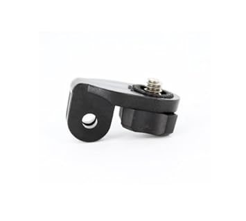

I use a Gopro mount with a little adapter that cost £1 off gearbest.
Posted : 10/08/2016 12:24 pm

I don't get that - all my mounts have the 3 prongs on the mount, so the light/gopro has to have the 2 prongs like my pic above no?
