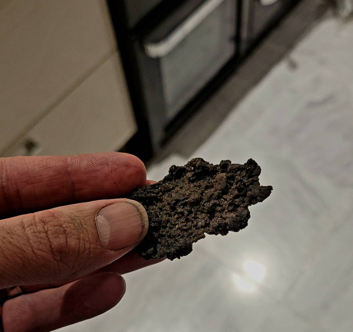

Posts: 1087
This is what was left of my sealant when I slashed a tyre at Gisburn 😆 20241227_162256.jpgย

Posts: 10498
@halifaxpete
Did you mix it with a spoon of dirt form your garden first?
