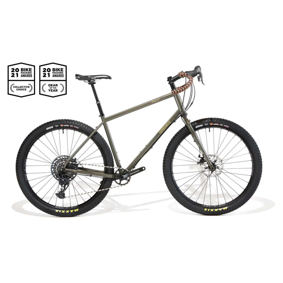

Posts: 3642
I’ve tried the OnOne Geoff bar on a Longitude 29er but feel it would maybe have been more suited to the Vagabond as on the Longitude it felt somewhat ‘cafe-racer’. ymmv
Not my cup of tea (the bars) but the Vagabond is quite similar to a Fargo and not quite so rocking horse poo. I miss mine as unknowingly opted for slightly wrong size when bought, and so swapped for a Longitude which was available. I’d have both!
Posted : 18/01/2022 9:55 am
Posts: 4789
been looking at the same.
One issue with the Fargo XL is that due to the steerer length of the fork, you can not get the bars any higher than you can on the size large... so in terms of stack loose the benefit of the high stack - unless you another fork with a longer steerer..
just to keep the STW ideals - possible alternative, bit less stack, but non suspension corrected fork etc - more money in UK due to shipping, vat duty etc..
https://tumbleweed.cc/products/stargazer?variant=40647438139573
Posted : 18/01/2022 10:40 am
Posts: 3642
^ Stargazer looks nice
A medium Tumbleweed Stargazer frameset weighs in at 8.85 pounds (4kg)
The (Reynolds 725) 2021 Vagabond frameset is claimed at 8.88 pounds (4.03kg)
I do slightly prefer the colour of the Stargazer (yet like both). More frame-mounts on the Genesis, more fork mounts on the Tumbleweed.
Will just have to look at them some more later and dream on 😎
Do Bombtrack still make the Beyond? (‘Beyond’, ‘Stargazer’, ‘Vagabond’ - all lovely escapist/long-distance conjuring words). You have to hand it to Salsa for naming theirs after a Coen Bros film?
In the brainstorming session for this steel-titanium touring bike, the team was naming places that are in the middle of nowhere. Former Salsa brand manager Jason Boucher chimed in with "Fargo" because he grew up near there. As we pondered it, we realized the wordplay of Far-go/go far. “It is like a bit of magic just happened,” said Mike “Kid” Riemer.
Ah 😉
Posted : 18/01/2022 11:28 am
