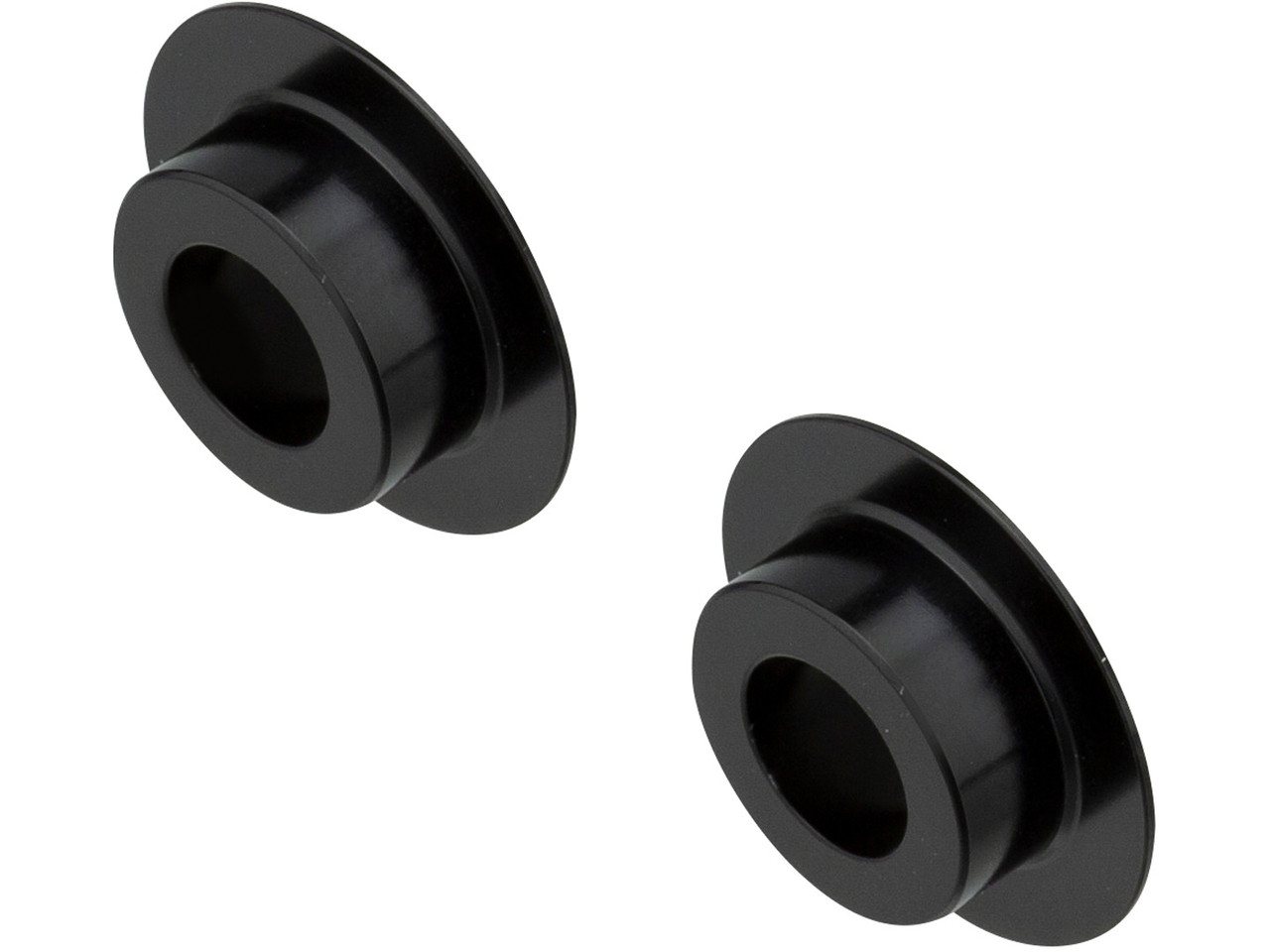

I have a Rockshox Vivid shock that has a bearing eyelet on the lower shaft end (30mm x 8mm bearing mount).
I would like to fit the shock on another bike that fits a 40mm x 8mm standard DU bushing eyelet on the lower end of the shock.
Does anyone have any experience of this - Is it possible to remove & replace the bearing eyelet on the Vivid & if so any recommendations on who could do it for me?
I am not sure if another viable option would be to fit 5mm spacers either side & retain the bearings as they are? Or would this put too much stress on the 8mm mounting bolt?
Thanks.

Yeah that link looks to be what you need. Otherwise it's a new shaft for the shock so full service plus the part ie. £150+

Superb, thanks guys - wasn't expecting a £6 solution to the problem!
I'm guessing I just need to source a 40mm axle pin now to slot inside the bearings/spacers?
Any recommendations on good manufacturers or should I just purchase a RS 40 x 8mm mounting hardware kit and not use the top hat spacers.

No, the bearing pin sits between the bearings on the RS mount I believe rather than passing through (the frame bolt does this) so just the £6 part linked.
Hope that's what you mean and should be easily checked with a quick look at the 8x30 setup
