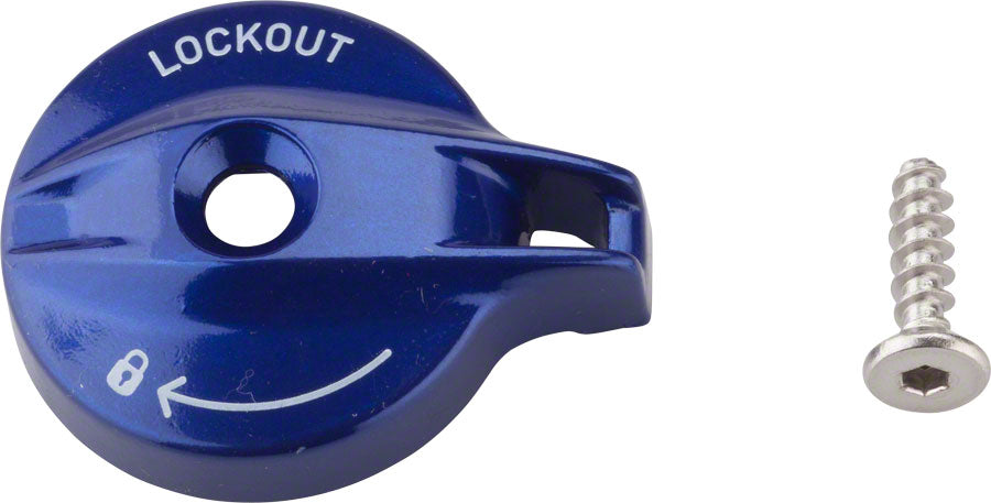

Ive got a 2025 Rockshox Reba RL (FS-REBA-10B-A9) with the blue manually turned  dial on the RH fork leg to lock it out (similar to link below). I see its Oneloc compatible and can find the bar mounted lever online, but I cant see how the cable would mount to the fork mounted blue dial to turn it. Is there a different dial for cable operation? If so any idea what its called / part number?
Cheers

Take a look on Srams website, they do parts catalogues
you'll either have a different knob assembly/pulley or a different damper
the options will be there
But, unless you really need it, racing or such like.. i personally wouldn't bother, set and forget, or only lock it by hand for very long climbs

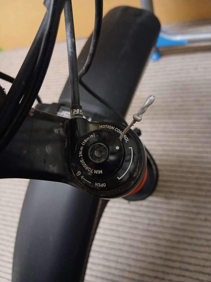

Ive got a remote lockout on a set of Rebas (they're 26" & fairly elderly, granted) which looks like this photo. Different to your image. Any help in the mechanics?

Yeah. You'd also need the sprung/pinchbolt top cap.
Pretty sure I have a completely unused lever assembly still in the packaging. for good reason.

Thanks - looks like its a RRP£90 part to change the entire damper cartridge (and another £60 odd for the lever)- so not worth it for me. Cheers.
