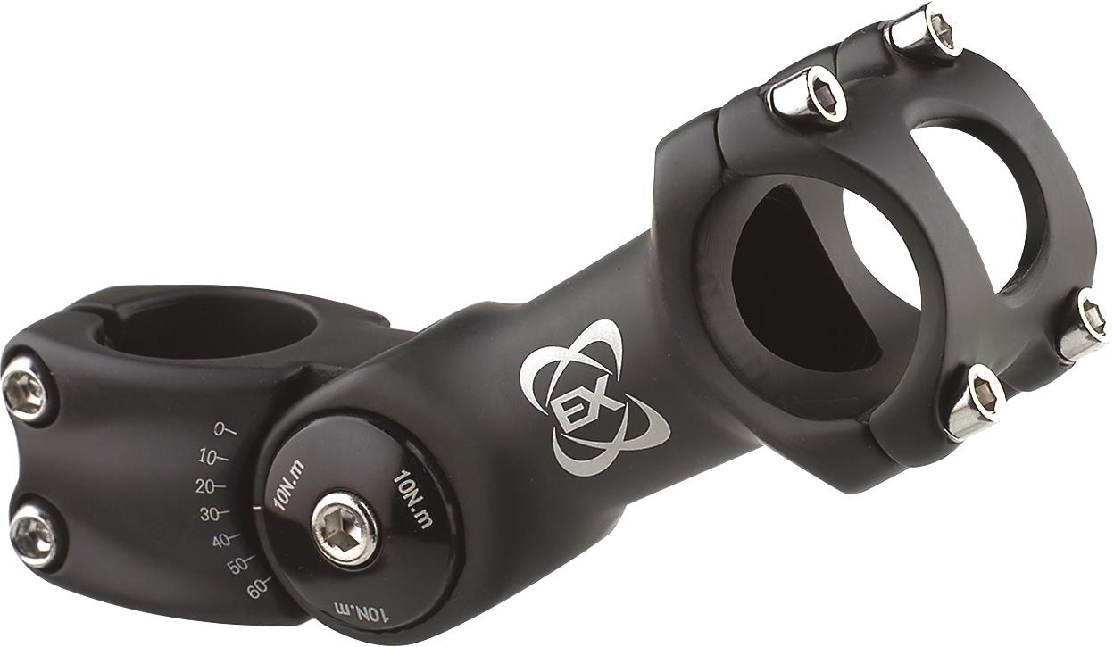

Posts: 13291
[img] http://i1.adis.ws/i/washford/410372?$pd_main_v2$ [/img]
or more

Not strictly a road bike, but Giants 'anyroad' would be tempting to me, had I not bought a specialized secteur a few years ago.
Though even with the secteur, I'm still going to have to get the fork swapped out, add spacers and an adjustable stem, etc.
Not a complaint as such, Specialized are great, but they don't sell any adjustable stems like the one pictured above that are compatible with their carbon forks. And you can't add spacers to the steerer without voiding the warranty.
