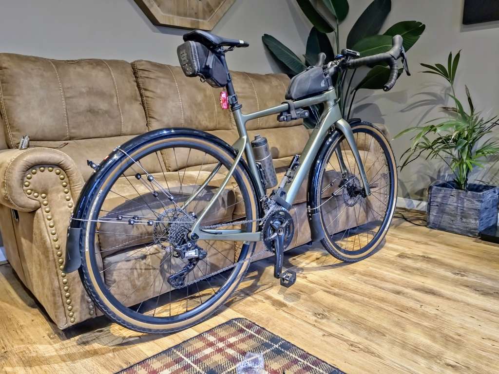

Posts: 14728
Eventually got round to buying and after sitting in the shed for most of the winter, finally fitting - Bontrager NCS 38-45 700c
All the mounting points were in the right place needing no bastardisation and the adjustable stays are perfect for the mid mounting fork holes. Dead easy to fit and adjust and good coverage
