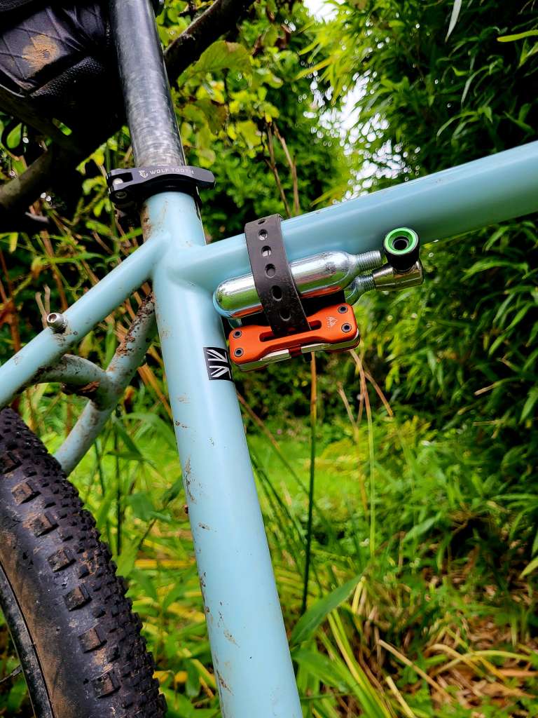

Posts: 588
Two Co2 cartridges and a multitool which contains a dynaplug
20230802_183326
