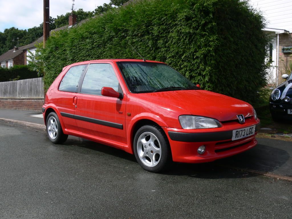

I had one, and it was pretty nippy, even as standard. Brilliant fun to drive! Watch out for leaky sunroofs, and general Peugeot electronics, other than that it should be fine.
Here's my old one.
Posted : 13/04/2011 4:01 pm
