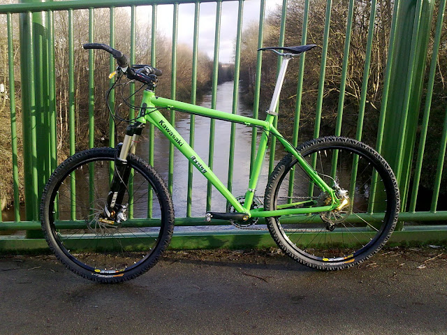

When TRH jnr MkII arrived I knew I would need a project to keep me sane during the never ending months of no riding and sleepless nights. I saw a Norco Charger frame on here and started to dream. That was ten months ago. Yesterday I finally finished Project Bogey.
go on, take it in.
and t'other side. Here's the front.
and from behind (s****s)
gold and cash green

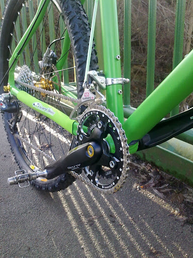

home made dual ring
drive

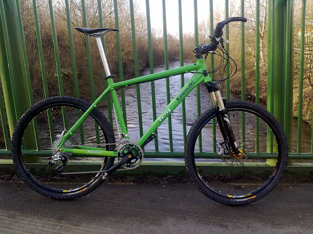

total cost £1053.63 and it fuuuuuurrrrking light for just over a grand. From the ride round the block I can confirm it's a whipper snapper as well. Makes me look good 🙂

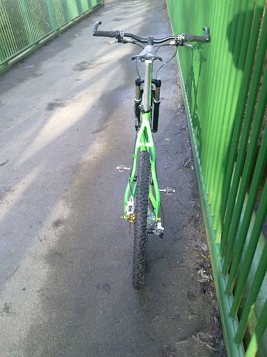

yer bar ends are upside down, pretty chainring

Bar end fail, MASSIVE TIME.

Nice color ! But yes the bar ends really do have to go before you ride it in public.

Nice seatpost and saddle, wheels too. Shame about the colour. Kudos for the Gripshift!

Interesting blend of drivetrain parts - I see X.0, Alivio and some 'SIS' Shimano...

Jesus THEY ARE ON UPSIDE DOWN

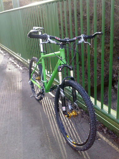

No less than 4 errors!
Bar ends are definitely upside down (and really shouldn't be on a riser bar)
The chain is too long (more weight to be saved!)
Front brake hose running around the outside of the fork - error (should be on the inside, this would not only protect the hose from scuffing and crushing damage, but the hose could be shorter and lighter)
Rear brake hose is too long
Possibly a fifth: Is that bits of cable outer between the cable stops to simulate a full length outer? Not only will it add weight (the outer is heavy steel), but it won't protect from dirt ingress as the dirt only get in at the ends & joints, it will even increase the friction in the bits with "extra" outer. This is a massive fail if my eyes are right.

Bar ends need to go. Nice colour though
Posted : 10/01/2011 12:16 am
barends on risers?...nooooo 😡
Posted : 10/01/2011 12:44 am
Bar ends are definetely upside down, and on riser bars. Stubbyish bar ends can look okay, mostly better on flat bars, but anything with a bend in really detracts from a bike IMO
If you really must have them, and don't want to buy any more, then try removing the plastic bungs from the ends, take a hacksaw (or angle grinder etc) to the bar ends just below the bend, clean up and square off with a file, reinsert the plastic bungs and you have some stubbyish bar ends, slightly lighter and less eye-scaring than they used to be
XC717 discs?? Rebas?? Elixir Rs, eggbeaters, XO carbon, yet alivio (square taper?) cranks and no name front mech? I'm confused
Frame looks a bit odd though. The angles and BB drop almost look as if ought to have a taller fork?

I don't understand why there is a kawasaki sticker on it.
To make it look cool... A bit like kawasaki bikes. Fugly as hell, soulless as a possible but green to increase the me me me factor.
Bike is nice, just need a flat bar, a bigger fork and a longer stem.

What's going on with the front mech cable? Almost looks as though it's been converted to rod actuation in the 6th photo!

Cables need sorting and you need a black seatpost to match the stem. Chain is too long as well.

you need a different front mech. Top-swing/bottom swing. whatever;s the oppposite of what you've got there. Keeps the cable snug

The bar ends are Codas from yonks ago and are most definitely NOT on upside down. I thought the 42t SIS front mech was a clue that I might be using some uber retro stuff but you all failed with your bike history. You can argue about the looks, fine, but they are on the right way.
Robdean - you have a keen eye! in my defence: bar ends - you're wrong, see above 🙂 chain length - this lenght so I can use all the gears that rear cassette is massive, f.brake hose - granted but never had a prob in past, r.brake hose - granted, Alivio - granted but it is HT1 so not as heavy as you think also I have issues with current outboard trends. Frame angles - blame Norco, defo a 100mm fork.
