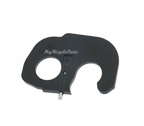

Never had a problem this before using a boist crankset. I can't get the little lock plate on the left hand crank to seat properly. The pin just isn't locating. I'm thinking that it isn't quite in line with the wee hole, but can't quite tell.

My M6100s have been like this for as long as I remember, but my new M7100s are fine. Sticks out by about 2mm.
Didn't realise these had a pin, I've probably bent it somehow although I can't imagine how.
plate

Took the arm of my M6100 off for a look.
The pin was indeed bent, but wasn't an obstruction to the tab going down as the hole it goes into is about 4mm diameter. Probably forgot to lift the tab sometime. Anyway, pulled the pin out for good measure, straightened it up and put it back in with a dot of superglue.
The tab won't go down flush even with the arm off the bike, because it comes into contact with the outer bolt. Remove the bolt and it goes down flush. The tab is the same one as my M7100 (haven't dismantled those), with a little step-up. Either the alignment of the crank arm holes is different, or one of the tabs has a deeper cutout to slide over the outer side bolt.
plate
The pin just isn’t locating. I’m thinking that it isn’t quite in line with the wee hole, but can’t quite tell.
You can easily see the pin in the hole when it's there, just need a torch.
