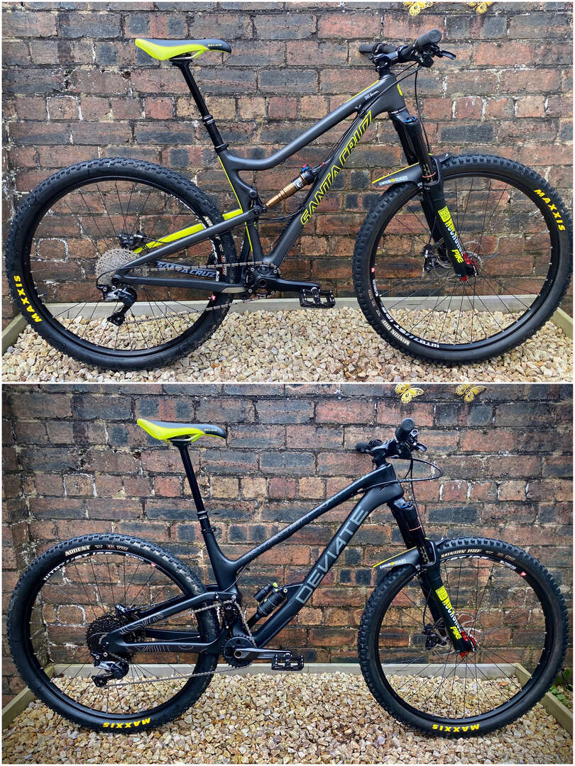

^ this. With steeper STAs on (mostly) newer bikes, the ETT can be surprisingly short comparative to the increase in reach between two bikes. ETT matters for how stretched out you'll feel when climbing. I jumped up huge amounts of reach but the super-steep STA meant ETT barely changed. However, steeper STA put me in a better position for climbing with increased reach making general riding along and descending much better. It's all linked.
FWIW, Mrs a11y is 5'9 but with normal proportions and swapped from a medium 2016 SC Tallboy LTc to a large Deviate Highlander. Reach changed massively from 388mm to 473mm! But ETT only changed from 586mm to 630mm. She couldn't be happier.

I tried/failed to add this pic to my earlier post as a visual example of reach vs ETT increase when the STA's steeper. Mrs a11y's old vs new. Reach is hugely increased but the relative increase in ETT is minimal - the wall bricks provide a good reference point:

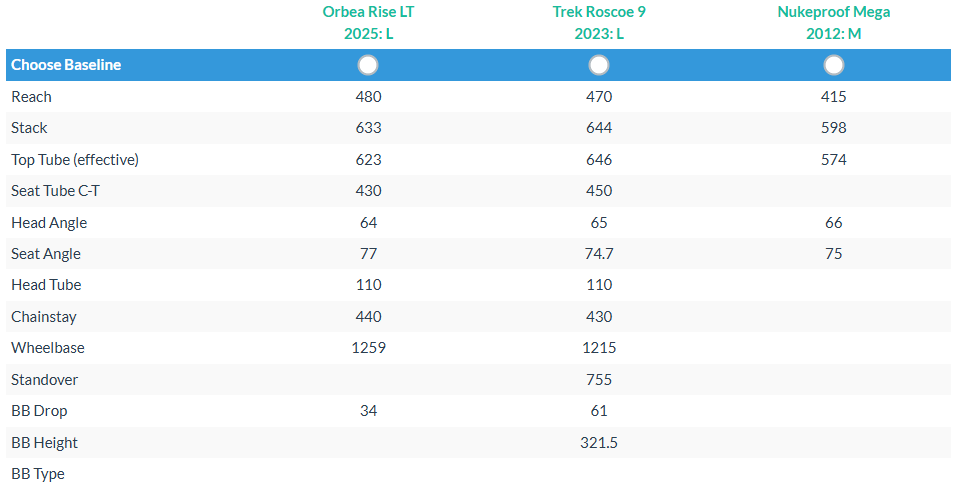

I've gone from medium bikes to large with the numbers increasing each time (I had a medium SX Trail and Demo 8 before the Nukeproof but no useful numbers for those on the Geometry Geeks website). I'm 5'11" and all of them felt really good.
At 5'9" you're on the lower end of large and upper end of medium in Whyte's size guide so you should be fine, but you've bought it now so just ride and see how you get on 😉
