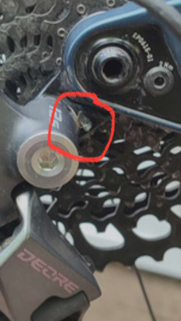

Posts: 440
What’s this mark on the hanger? If it’s a stone chip it could be affecting the derailleur movement.
Posted : 29/05/2025 10:12 am
Posts: 9231
B-tension adjustment?
Posted : 29/05/2025 10:48 am
Posts: 2221
Thanks all. The mark is just grease. The Deore mech and shifter are brand new with an Optislick cable too. The wheels are new. The cassette is almost new. Clutch on or off makes no difference.

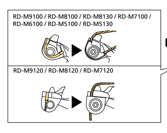

Posts: 12297
Useful diagram that cerrado-tu-ruido, I need to check the derailleur I cabled up on Wednesday evening now, although it worked OK in the stand.
