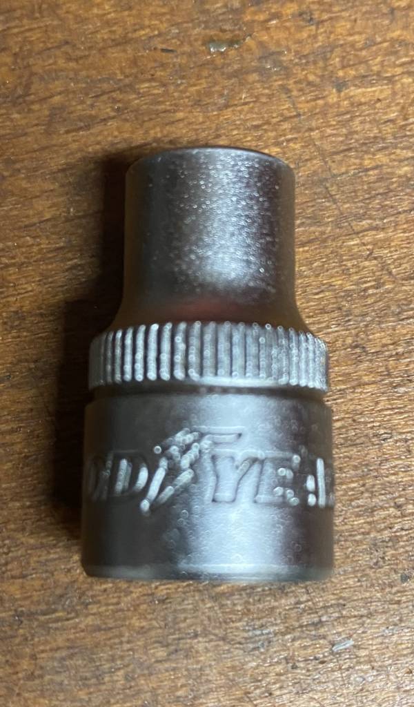

Speaking of Vault pedals, does anyone have a recommendation for a specific brand of socket that will fit inside the pedal body to remove the axle retention nut please?
The ones I've tried from Halfords are too wide to fit inside.

I use a Goodyear branded 8mm but any thin walled socket should fit. I think my old Draper did.
IMG_8088IMG_8089

I have a 1/4" bahco socket set that fitted just fine.

As for a socket I have a this set Linky

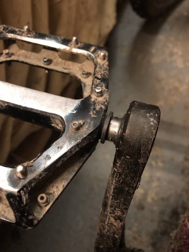

@goby thanks for that. Do the V seals extend above the body of the pedal?

IMG_6644
Looks like this installed
Posted : 25/09/2023 7:08 am

@goby
Finally got the bits to do this. Did you use the V seal in addition to the standard seal, or as a replacement?
Posted : 14/12/2023 4:38 pm
 goby
Posts: 606
Ah used the new v seal as a replacement for the original.
Posted : 14/12/2023 8:12 pm
