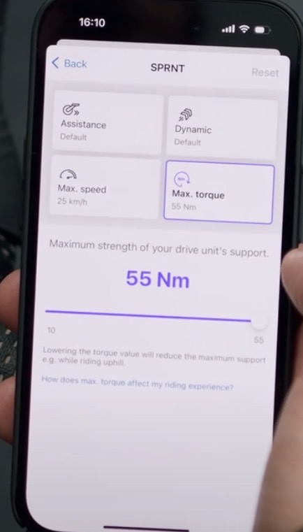

I have a fairly new Mondraker Crafty. Up until now, I’ve  been riding a lightweight e-bike with the TQ motor. The TQ feels really natural. I don’t at all dislike the Bosch, but I’m really struggling to adapt to the overrun feature. The overrun contributes a lot to the Bosch feeling so much less like a natural mountain biking experience. As I said, I don’t hate it. But im struggling to control it at times.
So my main question is, can I turn I off the overrun feature on some of the modes? Ideally, I would leave it enabled in the most powerful mode, but disable it in the more modest modes which I use most of the time.

@tjagain: my flow app only has 4 things you can control. Nd none of them switch off the overrun. So even if I rack back the assistance, torque and dynamics, the overrun still seems to be there. Am I missing something which is different on your app? Mine looks like this:

Ah - I could have sworn I had seen something about overrun but cannot find it now .  all I can find now is what you have.   I'll have a further look
