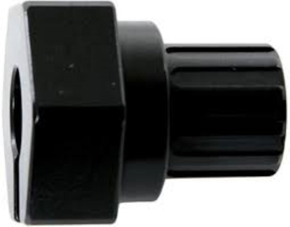

Over axle cassette ...
Over axle cassette lock ring tool?
Posts: 3081
[#13419335]
For an ebike with hub motor
Axle is 12mm and the cable protrudes from the drive sidePXL_20241018_113037698
Posted : 18/10/2024 1:31 pm
Posts: 14567
Drill through a normal socket driven one with spanner flats?
Posted : 18/10/2024 8:08 pm
Posts: 3614
Wolftooth flat wrench doofer?
Posted : 18/10/2024 8:48 pm

Posts: 4756
Posts: 44264
Can you remove the bit I've highlighted in red?
3k9gm9coqsa5q999l0sxtoakn3otmoyl
There's a flat in it that might allow it to be knocked round and unscrewed. It looks like that would allow the axle to be removed completely.
Posted : 18/10/2024 9:38 pm
Posts: 3191
Get a mate with a lathe to turn your existing tool down a bit on the inside?
Posted : 18/10/2024 9:58 pm
Posts: 1729
Is the cable hard wired to the bike?
Is the problem fitting over the cable (slot the tool if the cassette is not mega tight), or clearance between the axle lock nut and the cassette lock ring?
Sometimes you need to bore out a tool in a lathe to clear.
Posted : 18/10/2024 10:21 pm
Posts: 3191
The thin walled ParkTool with the long handle should work too? FR-5.2H?
Posted : 18/10/2024 11:08 pm
Posts: 2180
Posts: 14567
^ ah gotcha. Missed the slot requirement.
Posted : 19/10/2024 12:00 am
Posts: 3081
Cheers all, solved on the duplicate thread by a mate with a lathe. Bored out the socket tool to 15mm
Posted : 19/10/2024 7:39 am
Posts: 71
A bit late to this one, but I was fitting a new cassette to an e-bike for someone recently and he’d contacted the company who he bought the bike from as he was struggling to access the lock ring, for the reasons above. They sent him a special tool to do it, which turned out to be a normal cassette removal tool cut in half down the centre. You then just stuck both halves in place and it worked perfectly.
Posted : 19/10/2024 10:02 am
Posts: 3081
That would still need a bigger bore than mine had initially though
Posted : 19/10/2024 10:20 am
